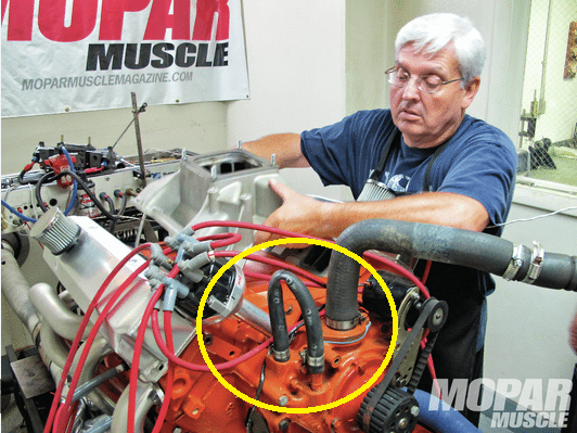

All pre 1973 pictures of 440's I've seen have 4 port or no heater valve.
After 1973, some 440's have 2 port, some have 4 port.
All mopar engines pictures I've seen except 440 have 2 port.
Why did engineers add expense of a 4 port than a simple 2 port? Maybe they found added pressure on the water pump when using a 2 port since it cuts off flow or adds backpressure? Or coolant is starved to the engine? Maybe they changed this defect after 1972 on all 440's? I don't know.
(To change to cable, I'd have to rip the dash apart. Too much work) I really appreciate all your help. I guess I'll play around and let you know in the summer.
Even Dyno testing, they don't just simply cap it off. I don't know.
