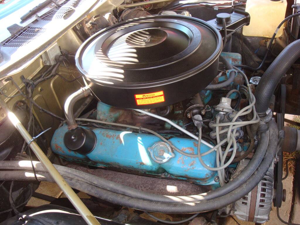

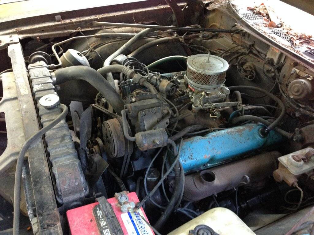

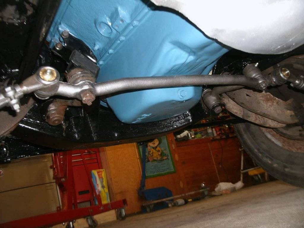

I have a distinct engine color recollection, circa 1973. My pal had a minty 68 383 RRunner that I did the heads and a cam for. My parents had a 71 Grand Coupe with the 360. The RR engine was definitely turquoise, which to me looked "old" like earlier Mopar engines. My parent's 360 was a whole different color, clearly a blue with no hint of turquoise. That blue is the same as Michel's oil pan.

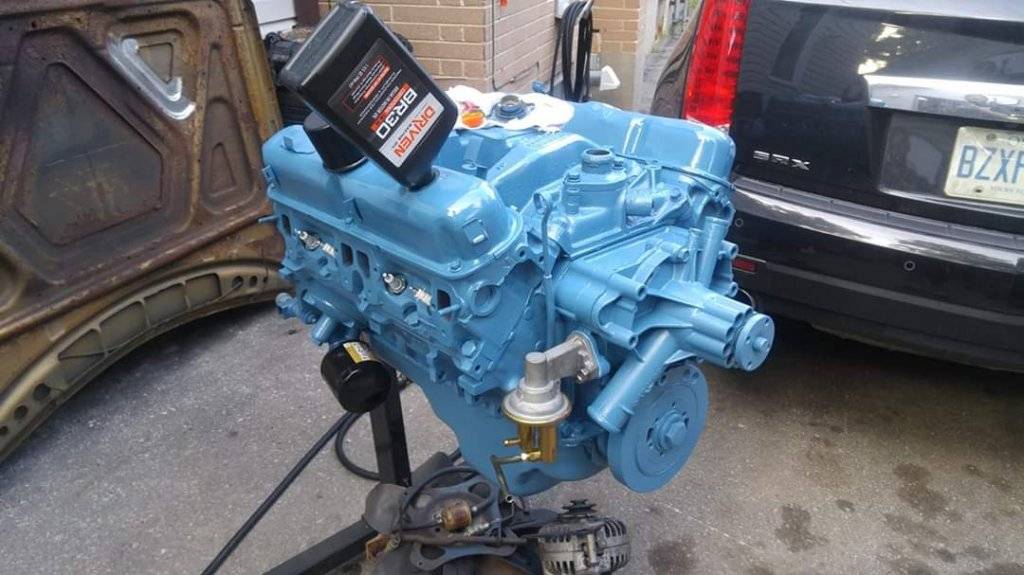

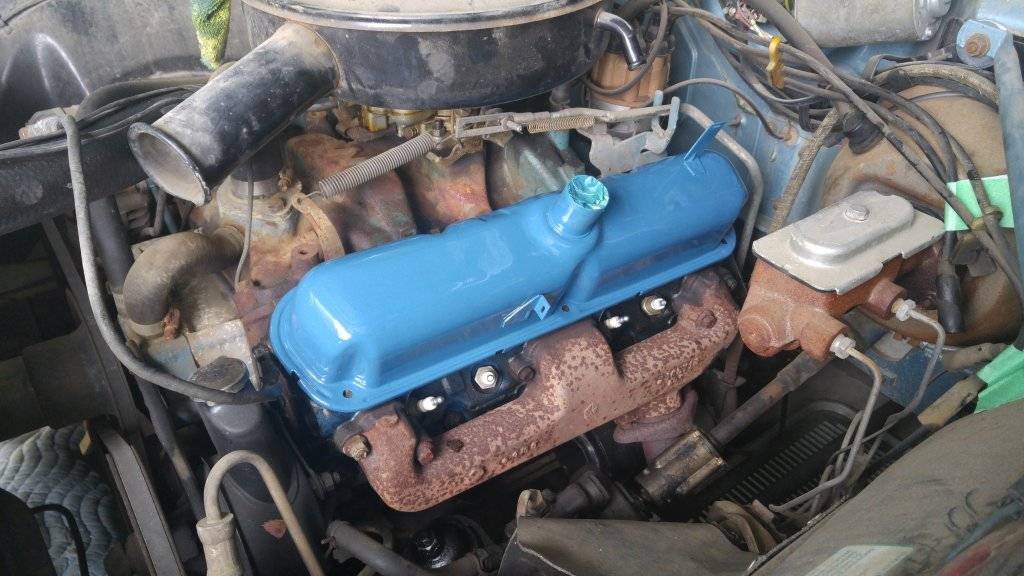

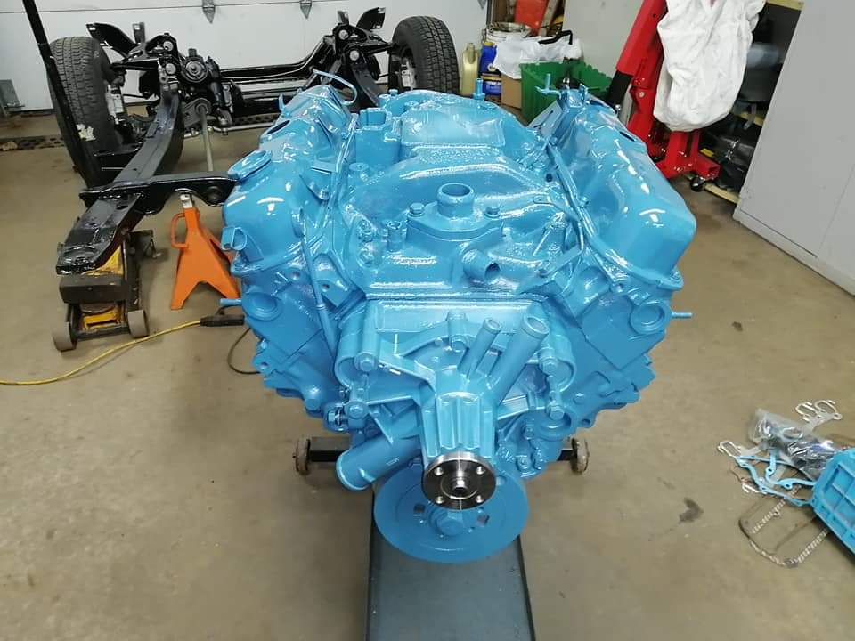

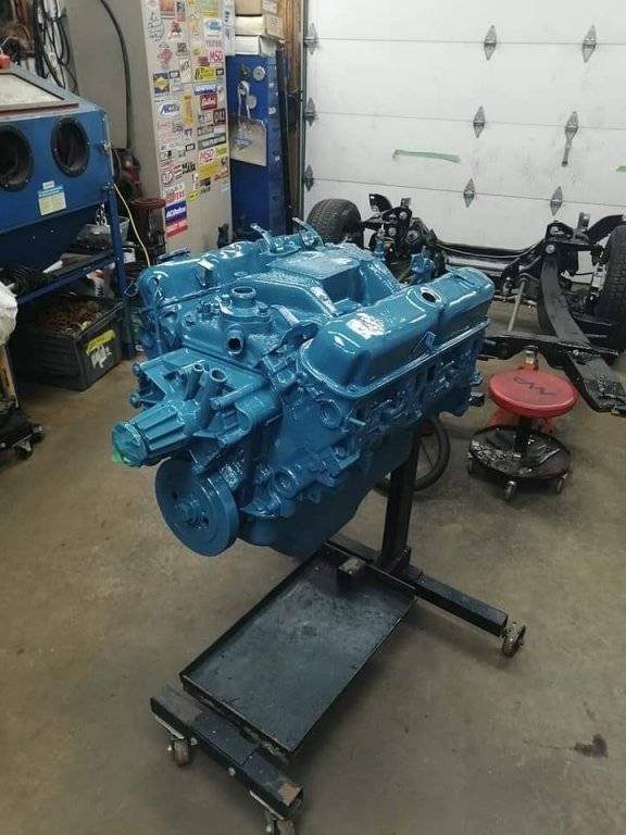

Below are two engines painted with Duplicolor Chrysler Blue...

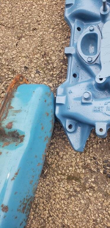

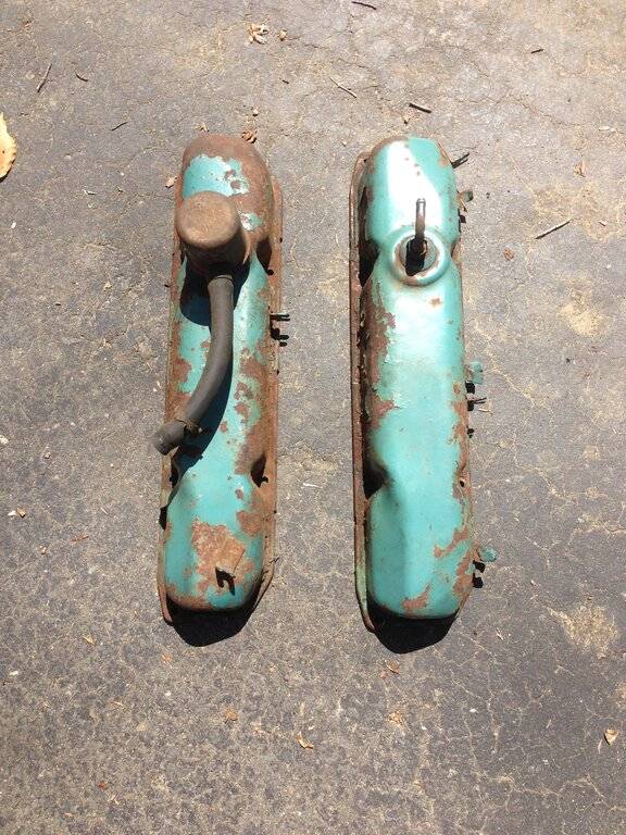

A photo of a set of original paint valve covers (with the usual fade)

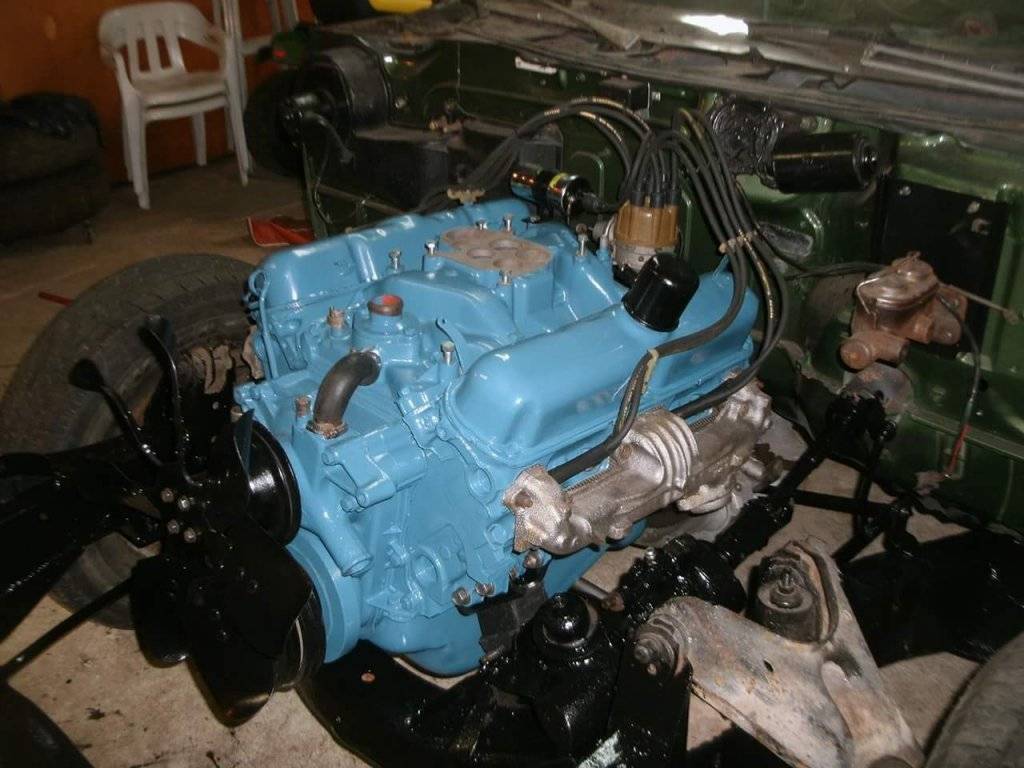

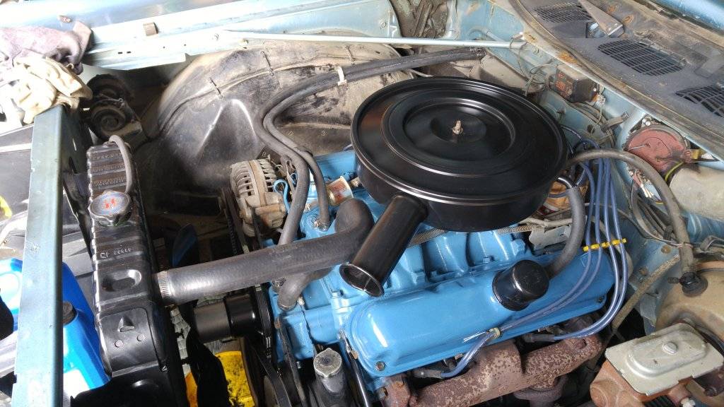

For what it's worth, I painted my 318 with Mopar engine paint from the 70s and it's much darker then I expected, I'm going to leave it as is because I don't want to paint it again.
View attachment 372085 View attachment 372086 View attachment 372087

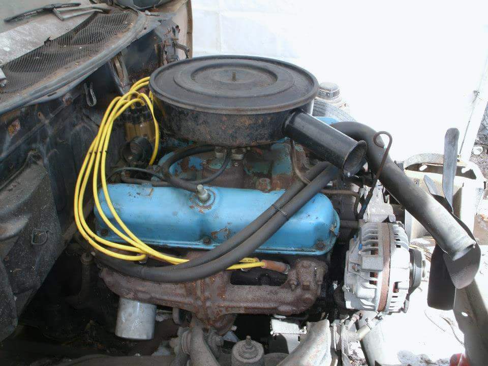

Actually your engines with the Duplicolor blue look exactly like my last 71 engine in one of my 300s that went overseas. I painted it last summer (no photo unfortunately) but since I live in California and the summers are hot, maybe that is why mine came out more like yours than what Ayilar showed in his comparison photos (water pump). Thanks for the helpful comments and photos.

This is what I used on my 70 $9 a can CDN at the Dealer

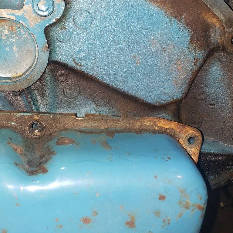

To complicate things, Medina's own pan (which is original) suggests -- but is not definitive -- that the original paint was blue, whereas the top is a dead match for the VHT SP126 paint. :BangHead:

Also there is some really clean paint on the bellhousing area of medinas block, matches the original valve cover perfect. (Pic three) Looks more blue green to me then just blue?
