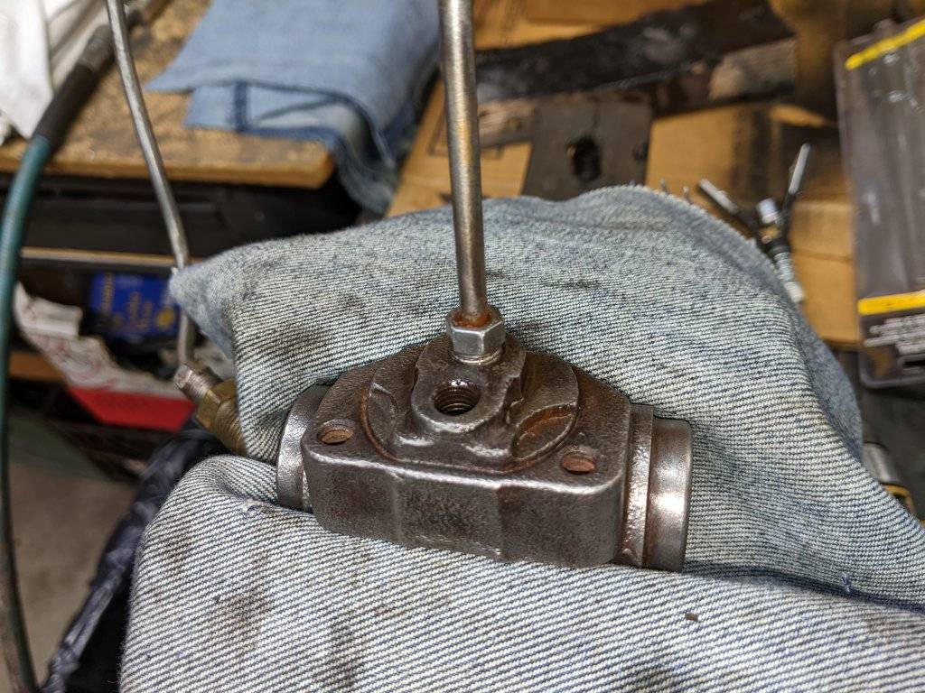

I am rebuilding the rear brake wheel cylinders for my 1971 Plymouth fury.
I purchased NAPA rebuild kit 491. The rubber end caps are too big and will not attach to the end of the wheel cylinder. Store manager tried to help, but found nothing.
I'm looking for seller and part number for a kit that has correct rubber end caps.

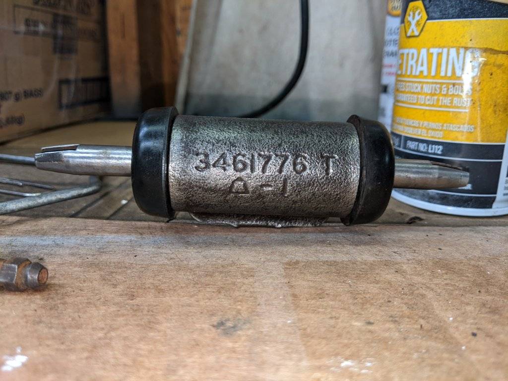

OE end cap left front. Correct aftermarket end cap, right front (no clue where I got it). NAPA junk in rear.
OE Wheel Cylinder, Rebuilt. Basically, I'm short one end cap to finish the 2nd wheel cylinder

I appreciate the advice. I like rebuilding wheel cylinders and reusing them. I am looking for a rubber end caps (dust caps) that work with original wheel cylinders that have a flat edge, rather than the aftermarket grove and raised lip at the outer edge. I may call Craig if I don't find a rebuild kit that seals.
@Samplingman: my 71 Fury has been off the road since 1978. End caps/Dust caps are 52 years old. I think they will disintegrate after a few days on the road. They also have a steel ring in the cap that clamps it on the end of the wheel cylinder. When I try to carefully pry them off the rubber breaks off the ring and the ring becomes oblong. Metal ring shows on left front cap.
Original wheel cylinders have flat sealing surface at each end

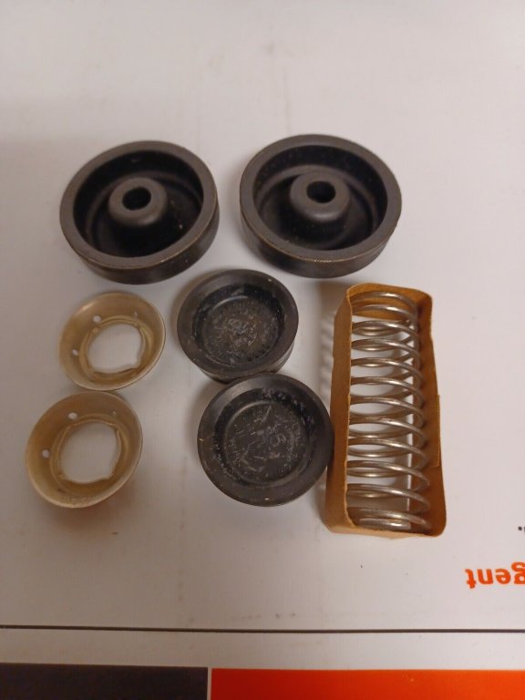

I ordered this part from eBay, Last pic is a measurement I asked the seller to make. I measure the flange 1.180" OD.
