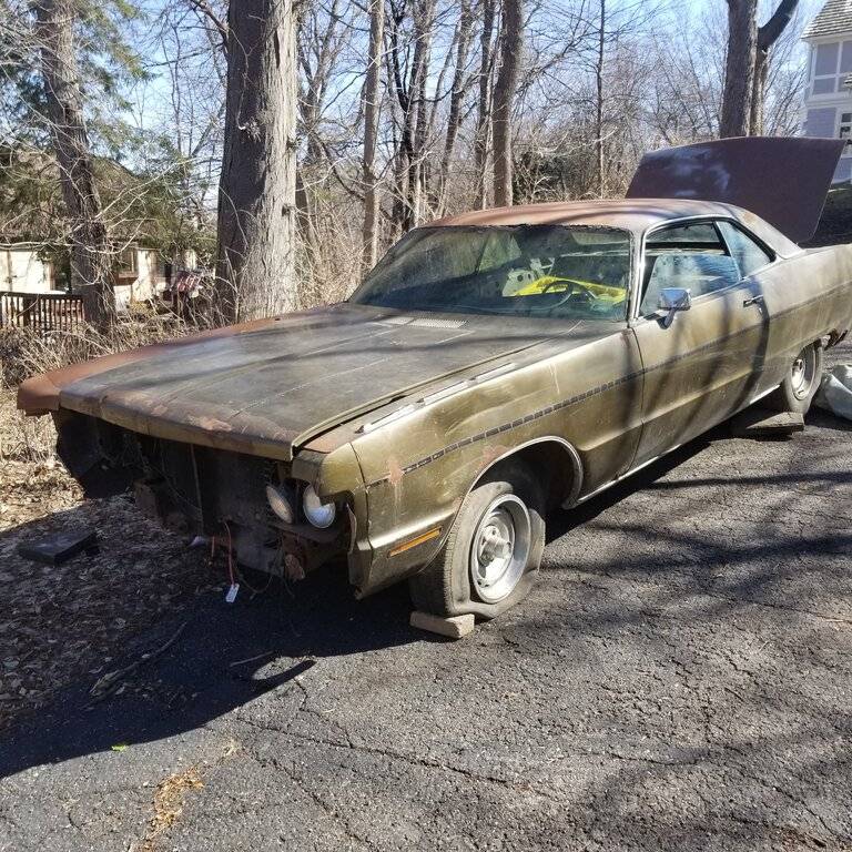

I knew of it for quite awhile sitting in storage, the sad part is it was robbed of interior ,front end and back bumper. Original engine ,tawny gold with black interior and black vinyl top .console car with the headlight wash system!!

Congrats! LMK if you need door panels or anything else. Trailer Park already bought the seats that I had. I may have parts that you need and I have someone reproducing correct stripe kits for 71 GT’s.
Thanks! Yes need black door panels, bucketvseats( if you know where some are) back seat ,back seat panels...I have the console! I have a question mine has the headlight washer but it's not showing it on the fender tag

No build sheet but fendertag is intact
It looks like you will need the ornamentation for the fender top mounted turn signal indicators on the passenger side - might be hard to find. I think they were used only on the 1971 SFGTs and then I believe I have seen some of those models with just the single regular turn signal lights indicators without the extra ornamentation - not positive though.
Nicely optioned car overall though. Good score!
Nicely optioned car overall though. Good score![
I have them they were in the car and I found the GT trunk emblem!

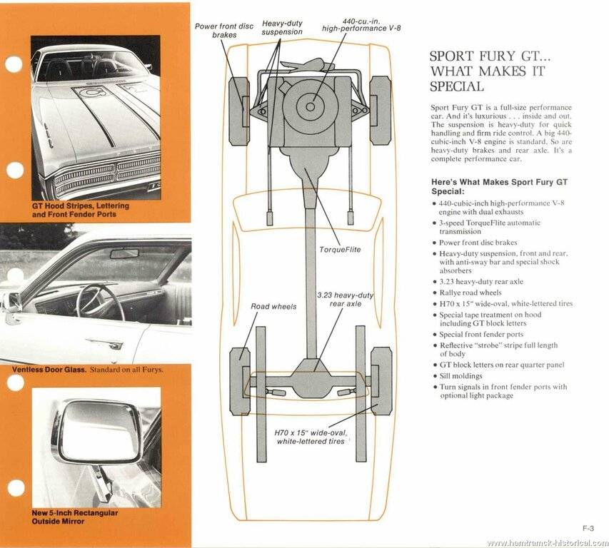

Looks like the "fender ports" were standard on the GT, but came in 2 flavours...with fender mount signal or none depending on if you selected for the light package.
What brand special shock absorbers did they use................? Koni.s ?
This may be a pre-production printing. My understanding is that the fender mounted turn signals with the matching trim pieces were an option. Based on the photos of '71 GT's, GT's that I have seen over the years and talking with people that have had them I would say that around 50% of the '71 GT's did not have these fender mounted turn signals. I have never seen photos of a '71 GT with the standard body painted fender top turn signal indicators. In 25 years of searching I have never been able to find the NOS matching trim pieces that go on the fender behind the turn signal indicators.
