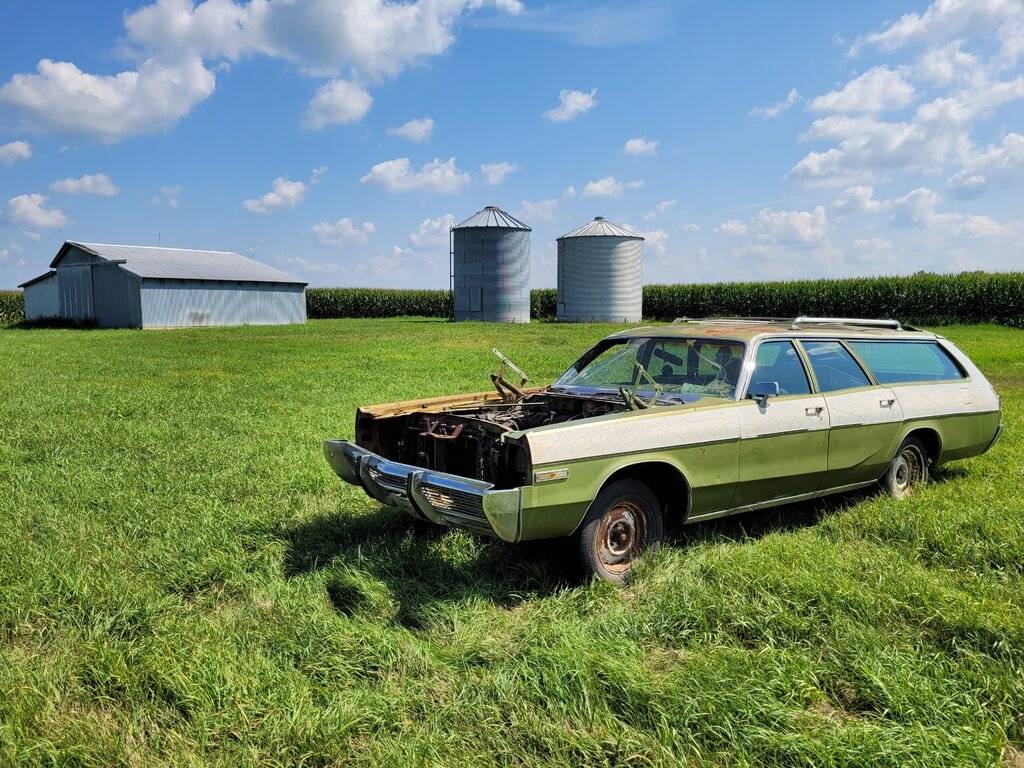

Ha! The top picture is the other green wagon I hauled back to IL in December.

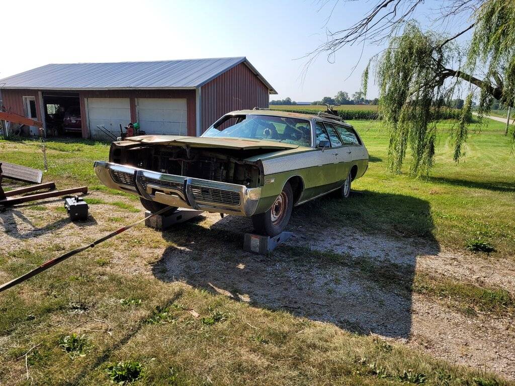

It mainly depends on how reassembly of the other green wagon goes!

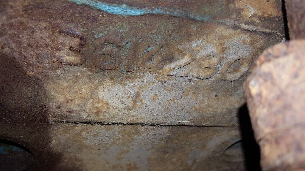

I'm not sure what numbers are on it. I've heard there are some 72 blocks that are desireable, but I'm not sure on the specifics...you must know more about it huh?Is it a 230 or 630 block?

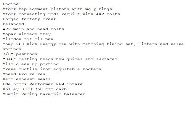

So far, I know that my 400CI motor came in a "C" body 1972 MOPAR. I also know that the 3614230-4 block I have is the heavier duty block with the thicker webbing. Hence, the preferable one to make a strocker out of.
What I don't know is, ¿ Did all 1972 MOPAR 400CI cars have this 3614230-4 block?View attachment 295692
