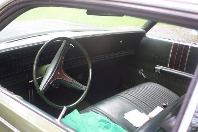

1972 Polara Dash (from internet)
1972 Polara from FCBO for sale
1972 Chrysler Newport (from internet)
1971-1972 New Yorker (From internet)
