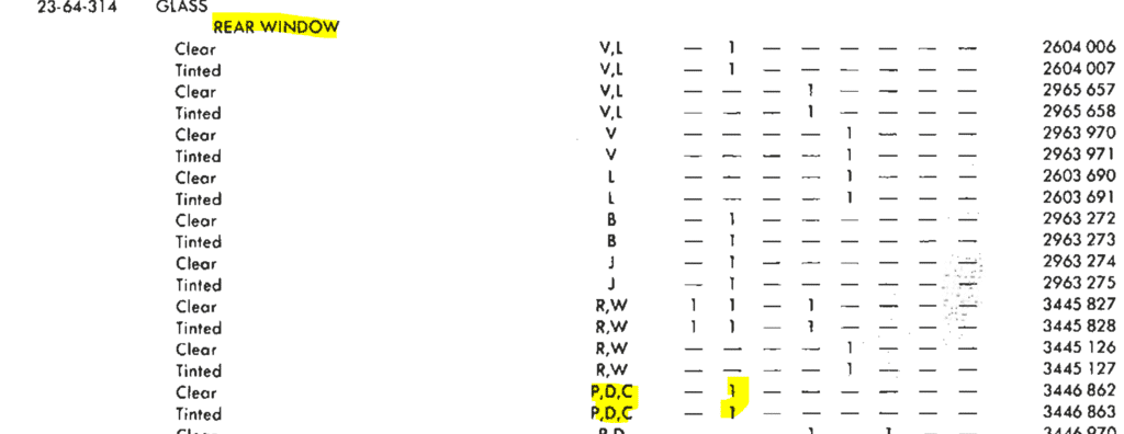

FWIW the same rear window is used on all 72 2 door Chrysler s from Newport to NYB.
