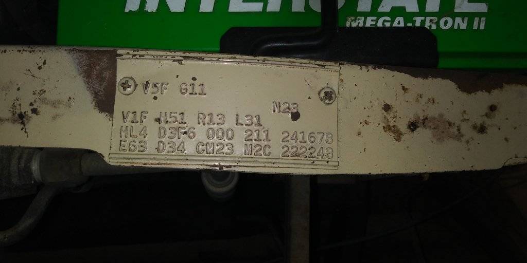

Feb 15, 2022 #1 ricks_RR Senior Member Joined Mar 19, 2015 Messages 1,006 Reaction score 1,268 Location n.h. can someone please help me with understanding more about this fender tag. thank you
Feb 15, 2022 #2 detmatt Old Man with a Hat FCBO Gold Member Joined Nov 14, 2010 Messages 28,563 Reaction score 28,444 400 2bbl, std duty trans, std ac, tinted glass, hood/fender turn signals, electronic ignition, high powered am radio, Parchment paint, green cloth and vinyl seats, bodyside trim with green insert, green vinyl top and feb 11th date.
Feb 15, 2022 #3 ricks_RR Senior Member Joined Mar 19, 2015 Messages 1,006 Reaction score 1,268 Location n.h. detmatt thank you now if i can find the bodyside molding with that insert the car will be complete

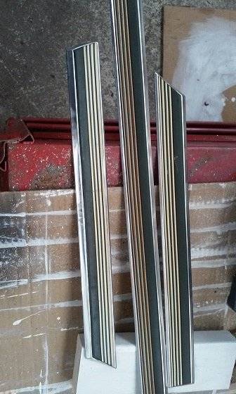

Feb 15, 2022 #4 ricks_RR Senior Member Joined Mar 19, 2015 Messages 1,006 Reaction score 1,268 Location n.h. here is a piece of it
