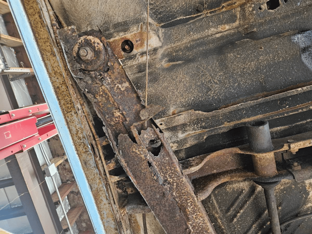

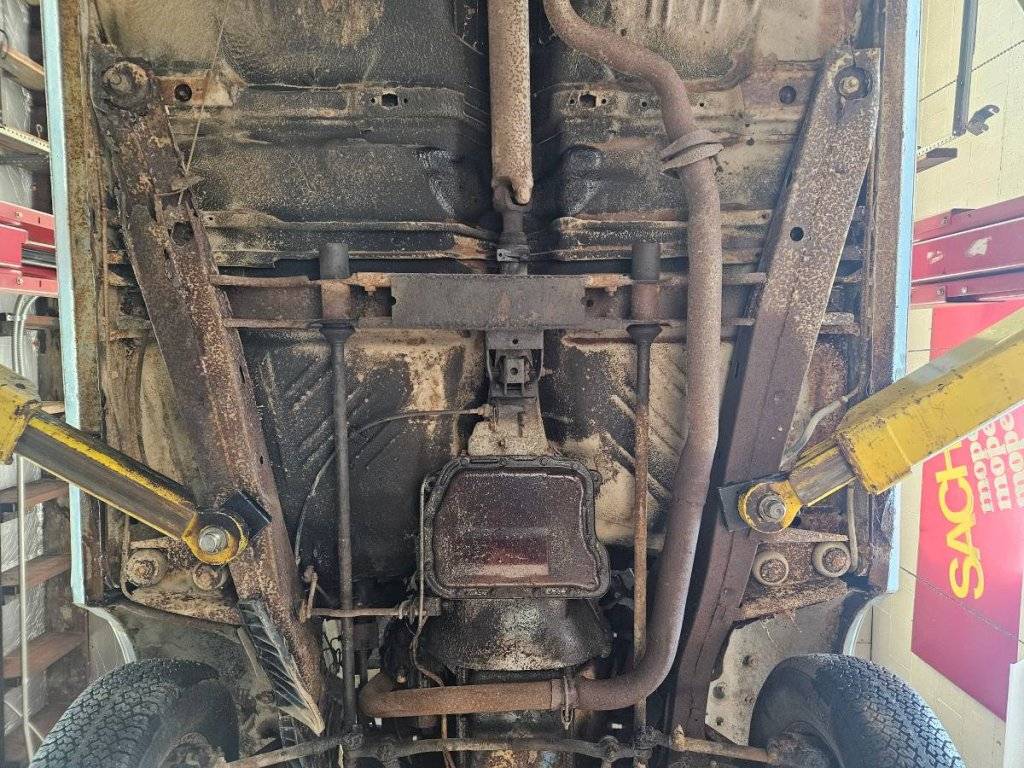

Is this saveable ? must have looked amazing when new

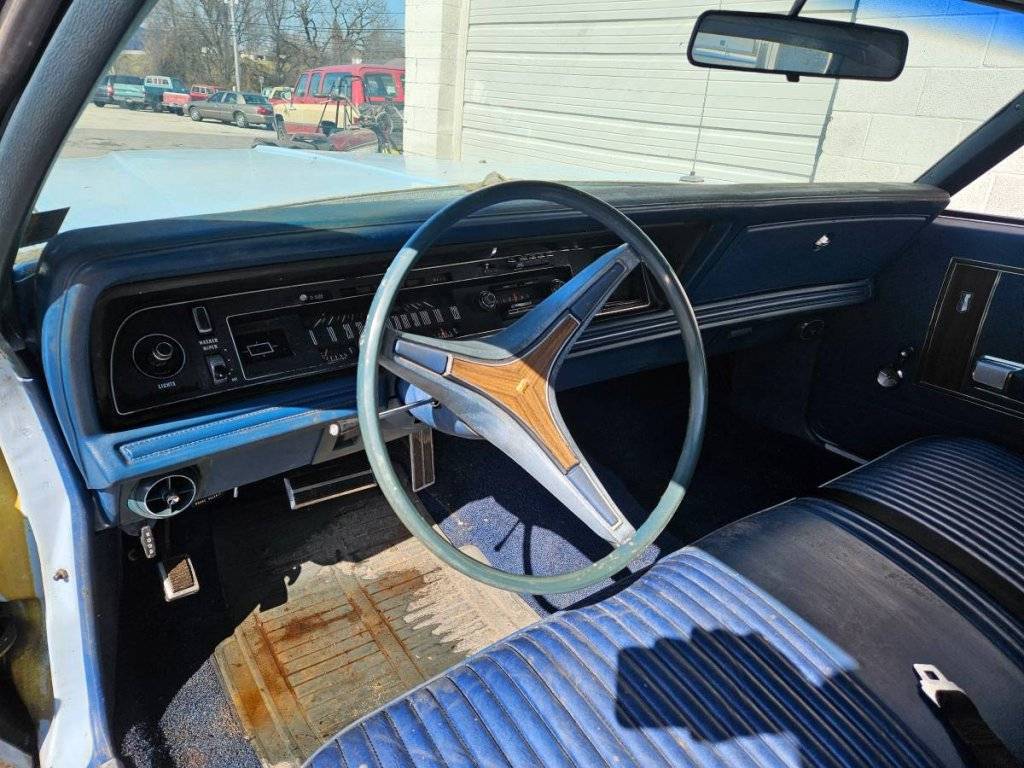

Thank you for posting CL23M3C131616 -- It looks like there is water ingress into the driver's compartment, I see some puzzling surface rust on the sides of the trunk, and I see some rust in an important areas (highlight below), but @71Polara383 can probably comment on whether this JB1 Newport 2dr can be saved.
Sure it can be saved. Assuming the stub is the worst of the rust, and you are willing. Sub replacement isn't too difficult, just time and space consuming.
Looks like the rear window may be leaking too.
If I were after it, I would source a stub frame and plan the swap. Regasket/paint the engine. Rebuild the front suspension. And the front of the car should last another 50 years.
Definitely savable. In fact, I think I could make a pretty good argument for fixing what's there with some fresh steel. The torsion bar section forward doesn't look too bad and really that's just the body mount.
Of course, the right way would be to replace the stub frame.
Even my decrepit a** :) is more where @71Polara383 & @Big_John are as to saveability. Unless this one after you get into it, you start finding other stuff (e.g., if the water in the driver floor is NOT coming from where we think?:confused:).
I aint a player here at any price, but this one appears mechanically salvageable with reasonable effort in skilled hands.
