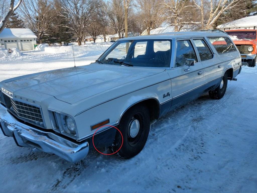

Are you driving it in the snow?
Your wagon looks good enough that I would fix the rust issues and clean up the engine compartment.
It's not in bad condition compared to most Formal wagons (Mr. C's T&C is beyond exceptional) we see here.
"SPECIAL ORDER" was obviously some sort of fleet order. Hence the lack of woodgrain, but still with the "divider moldings" all the way around. The lower paint could have been part of a "Special Mask" paint option, too. But the seat upholstery screams "fleet vehicle" to me.
Miles?
A neat vehicle and a low-production number car, too. Just "a wagon", but one that wasn't used and then discarded, too much.

@CBODY67 Some one added the green paint and pin strip. I can find spots of over spray. Plus the area I circled is just aluminium tape that if you lift up is white underneath. The mileage is 15,286 but I'm guessing it has rolled over once.

From what I can see, the exterior doesn't look that bad. If the floors are rotted out than I would just drive it until it falls apart.

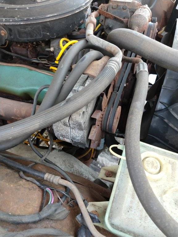

What is with the alternator in this pic

The alternator? Looks like the optional 100amp that came with the electrical rear window defroster on the sedans? Possibly the same option on wagons?

ONE thing I like about that 100A alternator is that it basically uses the late '60s mounting orientation, which lets the fuel filter be more accessible, in the open air, rather than hidden by the normal Chrysler alternator mounted lower.
