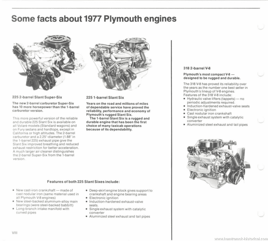

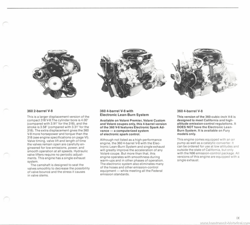

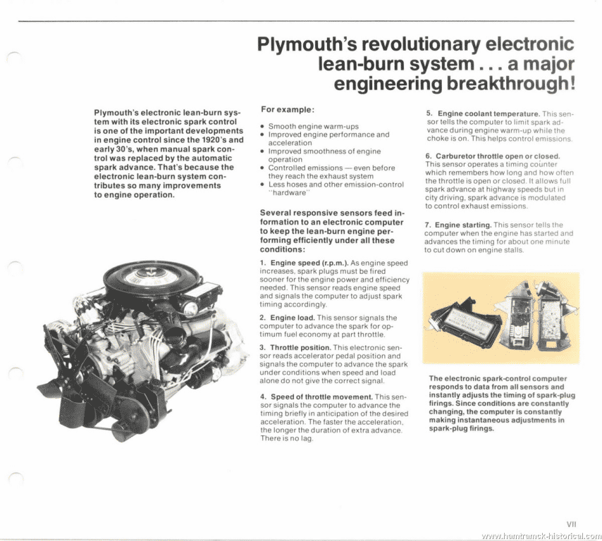

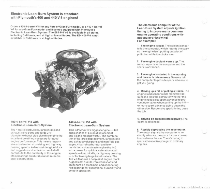

1977 Dealer data book. The 1970 Hamtramck Registry - 1977 Plymouth Dealership Data Book - Engineering
