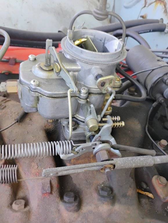

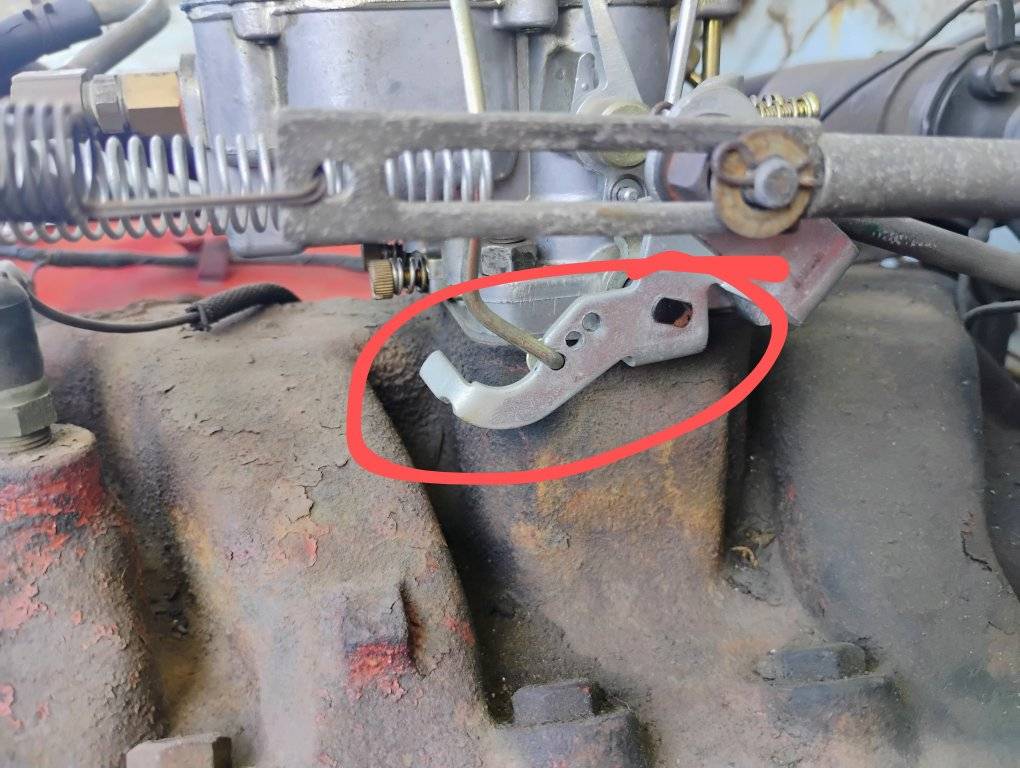

So since I've been using the fury is a daily driver it's been running good the only thing I have that comes into question is the carburetor for some reason if I'm at stop like a red light when I go to gas it when it turns green it'll bog out at first and I have to keep my foot on the gas to get it to go again and if I put too much gas to stalls. So in an attempt to fix the problem it took the carburetor apart readjusted the fuel floats and put it back on didn't fix it then I adjusted the throttle linkage to the next holes down as shown in photo I circled but it's still bogs on takeoff still, anyone know what the issue might be?

I'm not super familiar with this 2bbl, but (correct me if I'm wrong) the accelerator pump shaft looks like it is sticking out too much.
