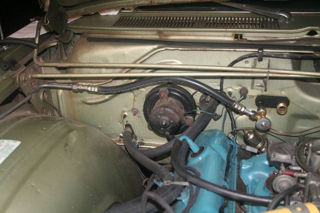

The hoses are hooked up in this pic I shamelessly stole off the intrawebs.

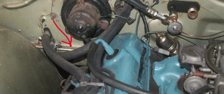

If it's toward the bottom of the firewall I'm guessing you are not referring to these.
If it these two they go to the heater valve that controls the coolant going into the heater core.
Another picture for reference.
If it isn't any of these and they are located behind the engine just about the lip that the arrow points to in the picture below then they are the drains for AC evaporator.

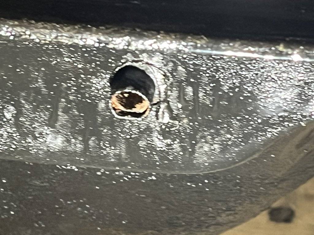

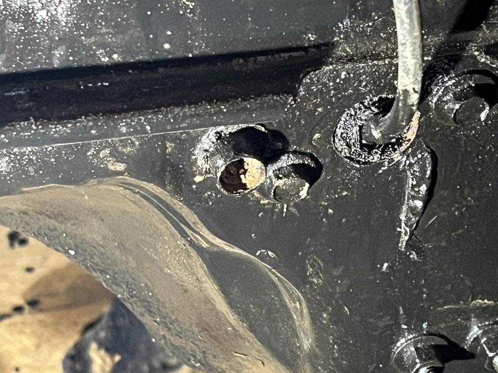

These are the holes, they’re toward the transmission slot in the firewall. The third pic it might be hard to tell. Thanks
