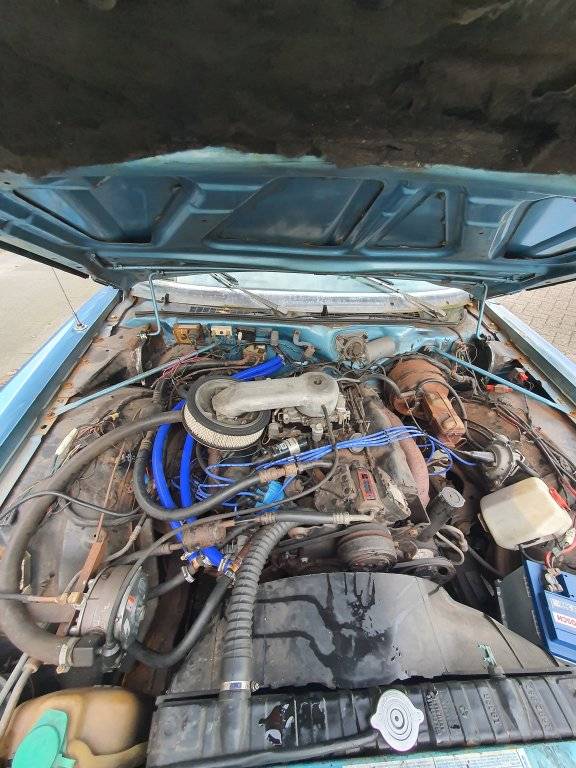

Hey guys.
My 74 town and country i just got didnt have any heat comming in. Quickly fount that thee heater core was disconected from the coolant system ,so that was an easy fix.
But now ofcourse i cant get ridd of the heat.
Now i think trying to work out the full autotemp 2 system( climate control) is going to be a time consuming battle.
I wonder if anyone worked a way around it and get it to work manualy in some way.
Heat on/ of
Blowing wind on the windscreen to defrost would be already great.
Anyone got tips?
Regardes ruud from holland

I think my controler is gone. So where the hoses to the heater core, so i replaced those but there now a direct conection to the core.
Btw it runs on propane so might look diferent.
But the bleu hoses go to the core

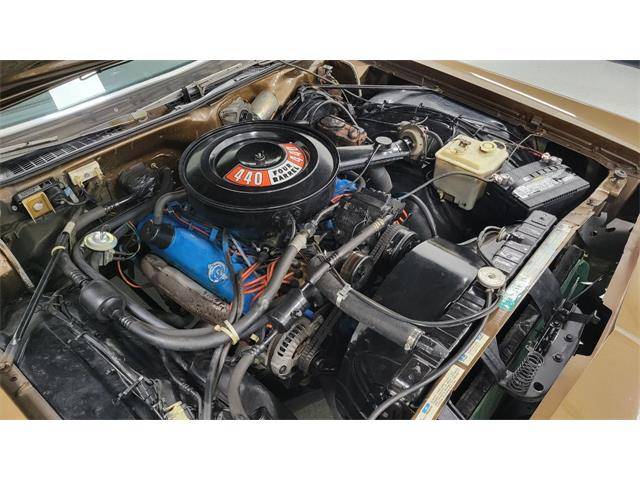

Yes, it is missing on your car. The Auto Temp will not function correctly and control temperature properly without it.
It should hang off the passenger side strut and both heater hoses and 3 vacuum lines go to it. I think they messed it up during the propane conversion because the "soup" can vacuum reservoir is also missing and the propane valve thing is in its place.
Attached is a pic showing the heat control valve (round silver thing) properly installed and you can just see the corner of the "soup can":
Thanx alot for this .
It conferms what i was thinking already.
At this point i think im just gona try to get the asential things working manualy with pushpul cabble things . Hot n cold and defrost is pritty esential in my climate.
I hava a bypasvalve on the way for the hoses. Need to open dash to see if i can sabotage the airbox doors in some way

I did manage to attleast put the defrost door open so i got wind on my windscreen. And my blenddoor works now with a push pull cabble, so i can get warm or cold air in. I think this wil be satisfying for now.
