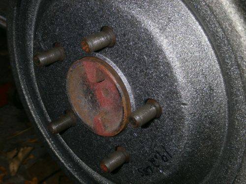

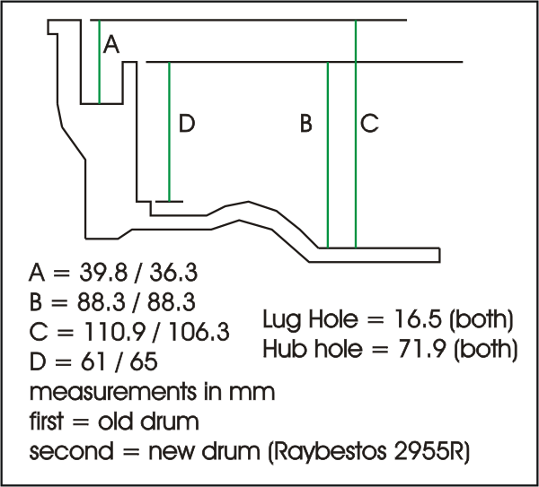

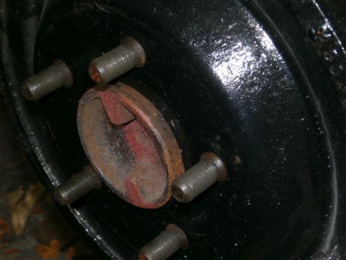

Here I compare one of my existing 2-inch drums with the Raybestos 2955R. My drum is of unknown origin, it is finned, as is the 2955.
The new drum weighs 8.78 kg / 19.3 lbs
The original drum = is 7.85 kg / 17.3 lbs
Measurement B is the most important, and in this respect they match.
The edge of the hub-hole on the 2955 is flared, and this seems to be the only major difference between them. This flare might interfere with mounting some wheels. I find that the magnum wheel (or what I think some people call road wheels) does seat properly against the 2955.
