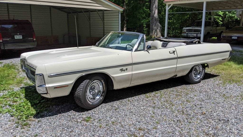

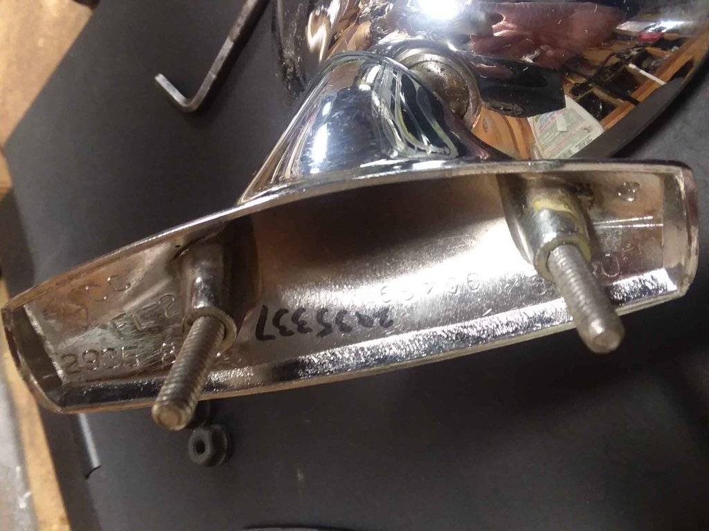

I have 2935873 remote driver side mirror. I think it's 1969-1970 Plymouth based on internet research. P# does not appear in my 1969-1971 parts books.
Can anyone confirm? If not, tell me what it fits?

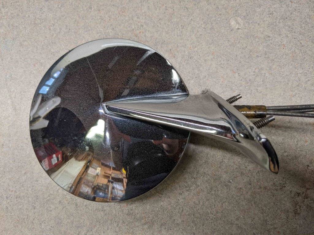

That number is only the casting number for the base. For '68 & '70 C Bodies MOPAR made 2 different mirrors that look the same. The mirror head is the same but the base is different. My recall is that the mirror for the Fury's mounted on the side of the door below the upper body line from the fender that continued into the door whereas on Chryslers and Dodges the mirror was mounted on the top of the door. It all has to do with the contour of the door and the angle of the mirror. Going by the photos I am thinking that your mirror is a Chrysler & Dodge mirror.

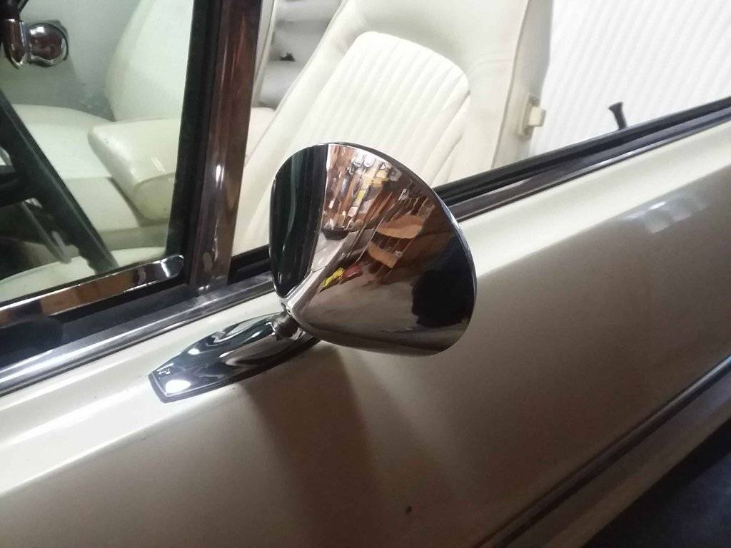

My 1970 Fury Manual mirror has the same curvature to the base as 2935873 and mounts above the body line on the door.

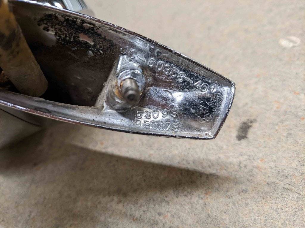

By contrast, Kelly Coleman was looking for 2935875 for his 1970 Chrysler 300, which has a basically flat base front and back.
Then my memory had things backwards and you have a '69 & '70 Fury mirror. They are hard to find.
