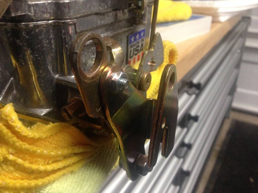

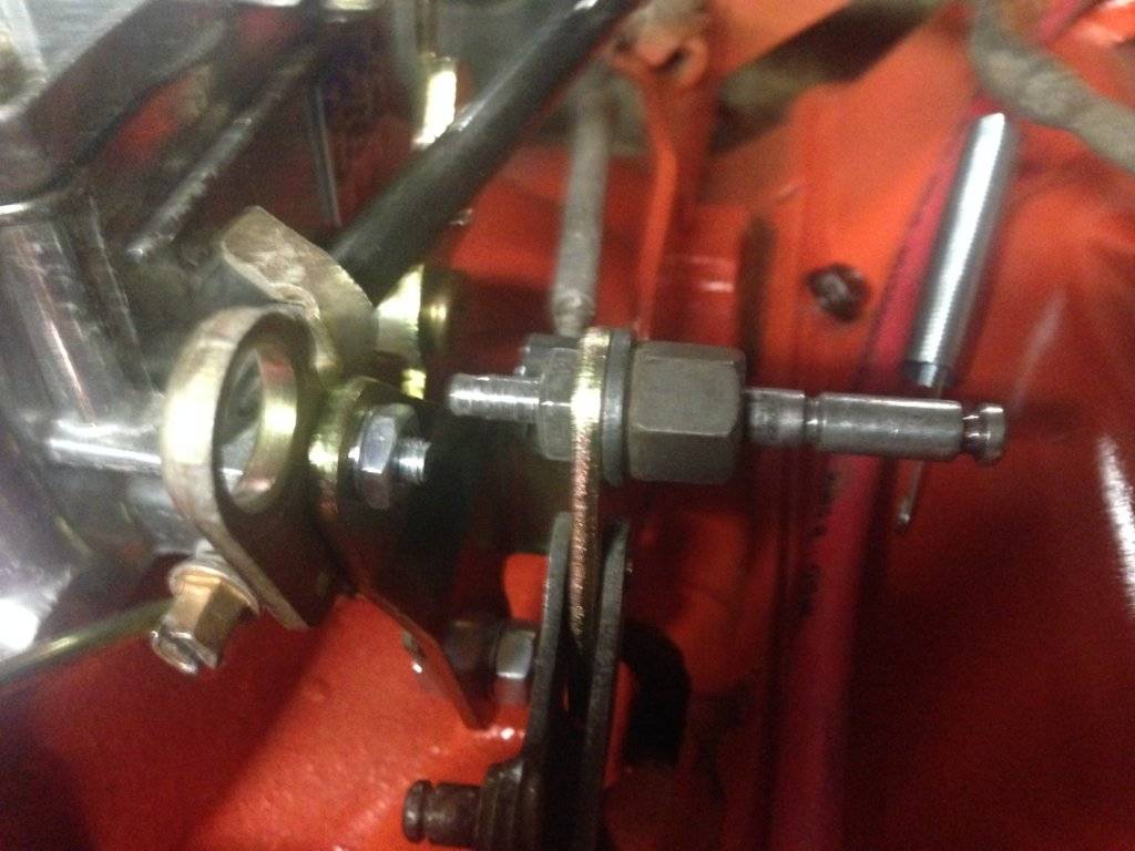

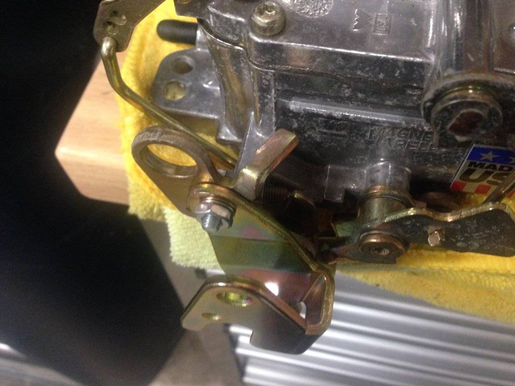

You need the 1481 Edelbrock adapter here are some pictures of mine with cruise control
It’s easy to attach, 2 small bolts and your on your way. Bolt it up just like in my pictures. Then just some minor adjustments on the cable after that. Your kick down may need some adjusting as well but I will leave that up to you. Good luck

The pictures I sent are of my 69 sport fury convertible 383. I too swapped out the 2 barrel for a 4 barrel . I used the edelbrock 1481 adapter with no other modifications needed. I just did some minor adjustments to the throttle,cruise and kick down linkage. I was able to adjust them all by about an inch.The adapter moves the linkage back by about an inch so it’s close to the factory 4 barrel linkage geometry on my car. That being said I did not have a spacer and my kick down linkage may be different than yours . mine is one long rod down to the transmission with the adjustment done by just spinning the slide linkage as it threads on to the kick down rod , I had at least 2 1/2 inches of adjustment. On my car anyway, it was an easy carb swap.

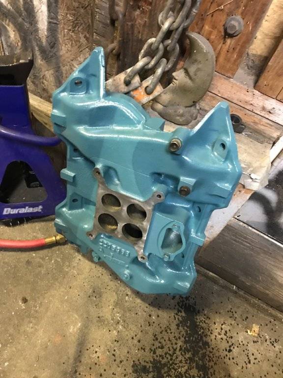

What intake are you putting that Eddie on?
It needs the thin Eddie adapter plate 2732 (comes in the manifold box if you bought an intake) if you put the Eddie carb on a Eddie manifold. Or you'll need Eddie adapter plate 2696 to put the Eddie carb on a cast iron manifold.

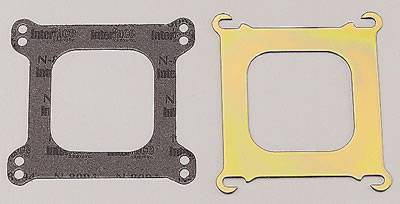

The spacer I used was wide open. It didn’t look like the one pictured
Did it look like this one?
As long as you can open the throttle to WOT you will be OK.
