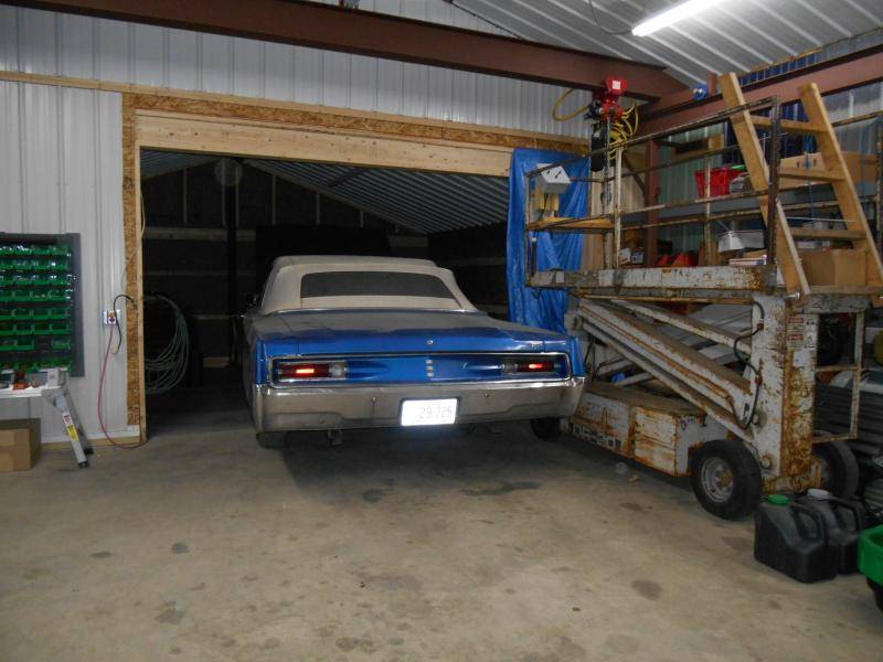

I finally have my '68 Newport home and stored in my newly expanded garage. It has a 2 barrel setup up now, but I have correct 4 barrel AVS and iron manifold for this application. My question is about all the linkages that I need to make this work. I prefer original stuff as opposed to cobbling something up. Can you guys tell me what I need and what years apply so I can begin searching. Does anyone here have a '68 383-4 they are parting out?Thanks, Mark:eek:ccasion14:
