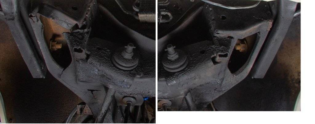

Lots of $$ for this one given the front end damage still present.
Yea good spotting, I'm surprised you could see that from the 100rds of thousands of miles of road grime built up on that stub frame that they thought some black spray paint would cover up.
:rofl:
Here's a hastily put together enlarged blow up of left vs right.
:rofl:

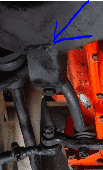

Looks like the pitman arm boss may have a weld repair. (residual MIG wire on part)

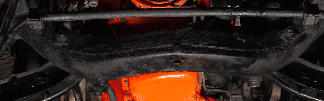

Front xmember looks to have a vertical bend in it. Or maybe that's how it was built.

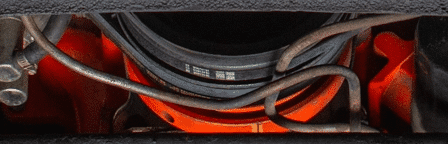

Trans cooler lines touching lower pulley?
Heh you got better eyes than I do, how can you see through all the crud? LOL
Naa the crossover of the stub (k-frame I know where your coming from) has a curve (normal).
The transmission lines all bent/out of shape going back to the transmission set off my sloppy work bell, but the pulley view takes the cake.
