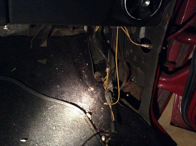

My courtesy/ interior lights work great when opening the drivers side door, but they don't work when opening the passenger side. I took off the front kick panel on the passenger side and found the following wiring. I looked in the FSM, but it was not much help.
I could not locate the male connector for the female. Where should I be looking. There is no power to the door jaw switch.
There won't be power to the door switch as it returns ground to the light.
Jump the yellow wires to ground at the door switch and your lights should work. If they do, the solution is a new door pin switch.
