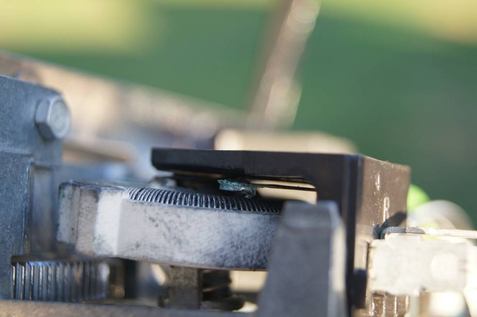

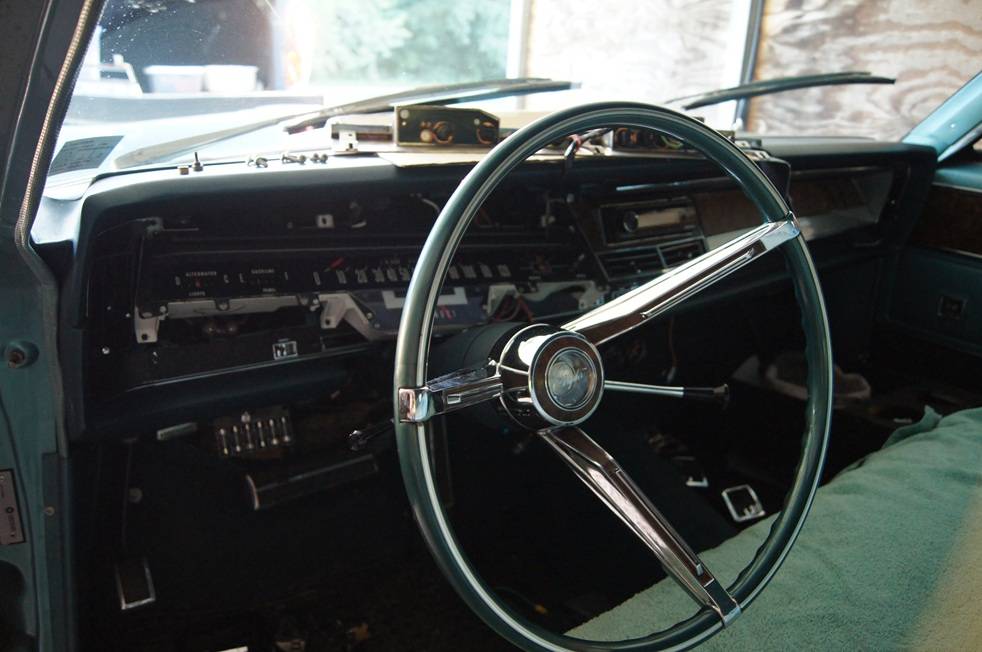

So I my dimmer switch is toast. The contact fell off the arm (it's still on in the photo). Had the cluster almost out tonight, I don't see any burnt or melted wires. Still don't know why I have no power on either side of the fuse? Time to study the wiring diagram. Thoughts of a work around? Cutting the wires to each lamp and running them through a fused ignition circuit. Dash lights on if the car is running.

The 1967 (ONLY) headlight switch may need rebuilding? They get corrosion internally.
The dimmer switch for sure needs rebuilding.

Update. I have constat power to the pink wire. I took the dimmer switch apart and cleaned it up. One end of the spring was broken. I cut it and reconnected it. Ohmed the switch and all seemed okay. Still no dash lights. So I did a work around and cut the wires and connected them all to ignition power. If the key is on, I have dash lights. I also installed a tach and replaced the coil (it was leaking). Back driving it to work again!
That dimmer switch can be cleaned, and put back in use. The wiper tab can be replaced, and soldered back onto the wiper. I've done just that with one in our '68. The Devin Dude is The Man for restoring these old switches for folks on this Forum, and if I ever get a problem beyond my Poor Man's Repair Methods, then I'll go to Devin. One can even use a piece of solid wire to make a new wiper for the rheostat. Your other option would be to replace the switch, and again, Devin is The Man for most folks here.
You REALLY need to restore the dash light circuit to the BATTERY side of your power supply! Leaving them on the Ignition switch will load the ignition circuit down too much, and you will regret it. Glad you found The Pink Wire! THAT one SHOULD be fed from the Battery side of the fusebox. Be DAMNED SURE you have some sort of FUSE or BREAKER PROTECTING THIS AND EVERY OTHER CIRCUIT IN THAT DASH! Turning off the ignition as smoke billows out of the dash might remove the overcurrent, or NOT, as when wires burn their insulation, MORE SHORT CIRCUITS OCCUR.
