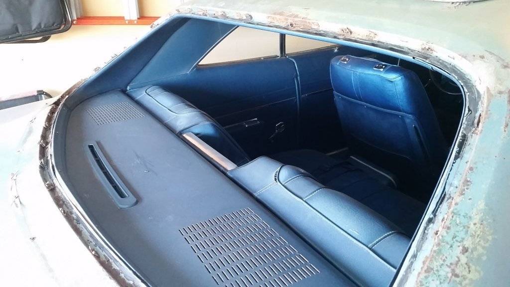

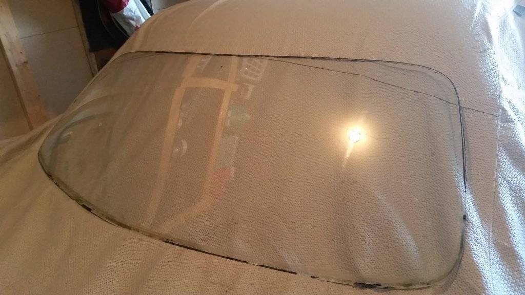

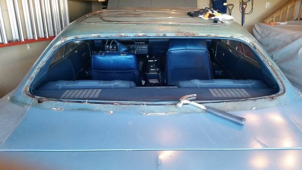

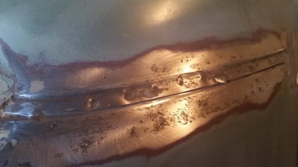

Well, I'm no Nick or Tom, but this was a good day for me. The glass is out and still in one piece.
OK you body guys, what is best to use for this? Just filler, or weld in a strip first to make the depression shallower?
If you're not putting the vinyl top back on lead would be the best. If the vinyl is going back on all metal type filler will be good enough. Ok here's my horror story about those quarter to roof seams. I was doing a 71 Cuda and I filled the seams with all metal as I had done many times before with no problems. On this car I was ready to paint and was doing the final wipe down when I could feel a depression all along the seam on both sides. I blocked it down and put a skim coat of filler on and called it good. I put it out in the to dry and within minutes the seam had shown up again. So I contacted the rep for USSC who makes the All metal. He came to my shop and was baffled. He said I was doing everything right including adding extra catalyst to make it harder. They tried to duplicate the problem in their lab with no success. What I finally found out after posting my problem on Moparts is that for some unknown reason E bodies will do this every time if you don't lead the seams. Why B, C or A body's don't do it is a mystery. The seams are identical to the e bodies. But because of the hard lesson I learned I lead all quarter to roof seams no matter what car it is. In your case Peter all metal should work fine especially since not many guys out there can or will work with lead.
Would there be any advantage to tack in a strip of metal to cover the gap, or is that just too much effort? My thought was if the whole gap was filled in with steel and then worked on with the grinder, very little filler would be needed.
Lead. No shrinkage.
That would probably just be unnecessary work. Fill it with All Metal and you'll be good.

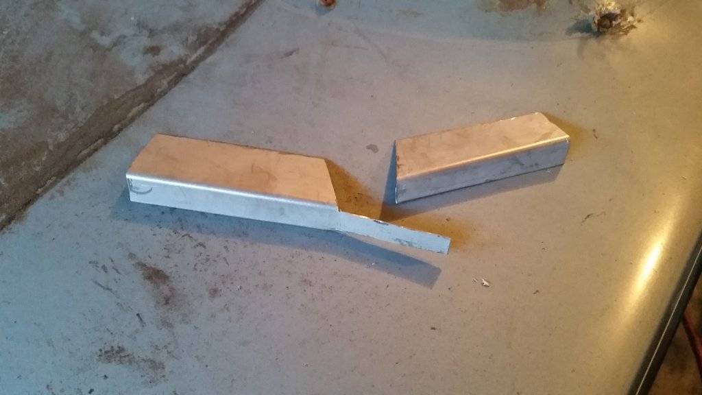

I was forced to adress the rust at the beginnig, resulting in complete strip down. But for some reason, I have lost the metalic clip holding the moulding lips on the rear trunk doors. I was trying to replicate them once, but not really hard or succesful. The moulding holds in place quite OK for many years even without these inserts in place, but I still want to duplicate it.
Would you be please so kind and would remove the moulding and took couple of pictures of the metalic insert, so I can try to duplicate it based on your picture? There is no rush at all from my side, do it just in case you get around it. Thanks in advance.
The metal piece is inside of the moulding, located on the inner side, where the tailights ends.
