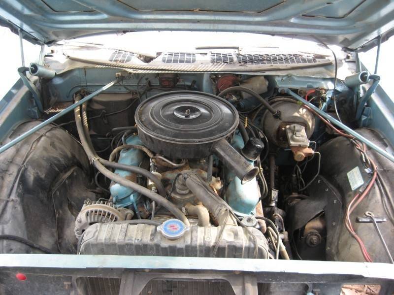

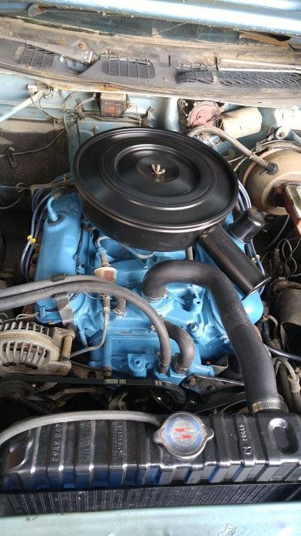

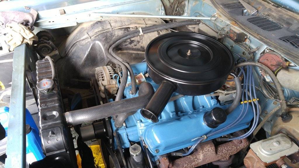

Any paint left on the oil pan? Is the engine original to the car or maybe was rebuilt? Not all shops were real religious about what colour they painted their rebuilds.
I had a 69 Belvedere and the 318 was red.
I've not heard about the late production thing. I was always under the impression that they were red up to 69 and changed for the 70 model year.
Kevin
Kevin

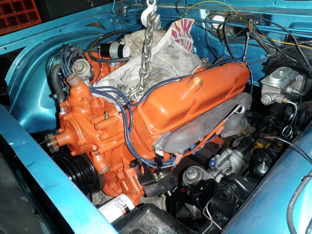

Oil pan appears to be turquoise or faded blue.
"Hemi Orange" :poke:
At least you won't be the only guy with the wrong color at a Mopar show:rolleyes:
I could, if I tell them it's a police version:D. Besides I already have one incorrect one.
It may not get the critter seal of approval, but it's close enough for me. All new hoses, belts, water pump, thermostat, heater hose support bracket, and wires. Rad flushed, cleaned and painted. Clean up and painting of fan, brackets and pulleys. New ground cable, too. Rad cap, fuel filter and line still to go.

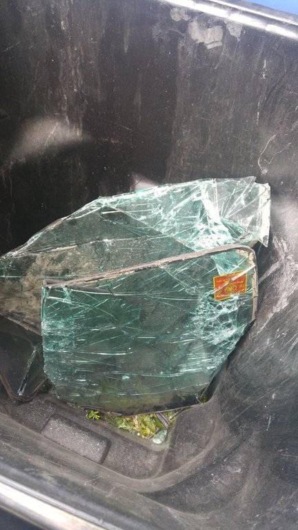

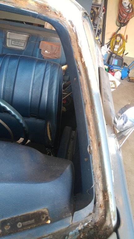

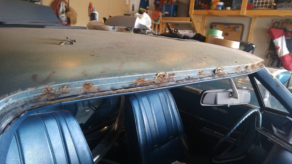

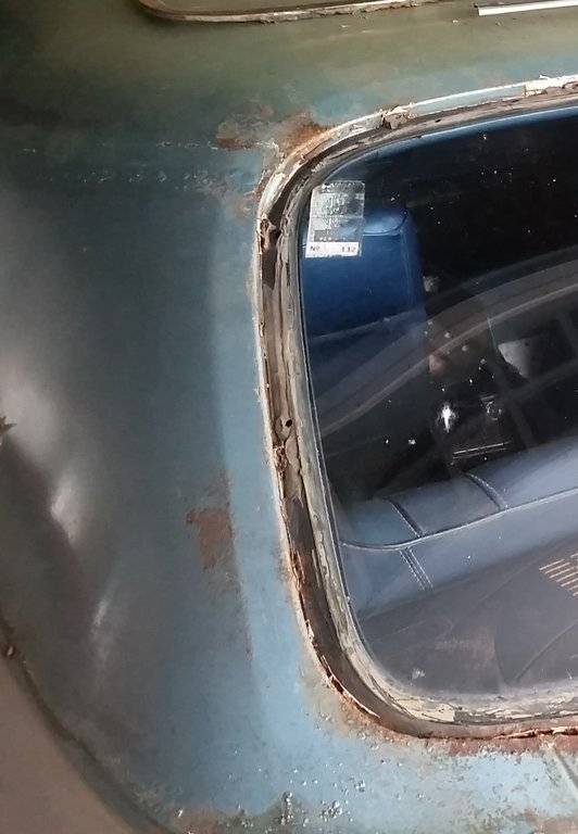

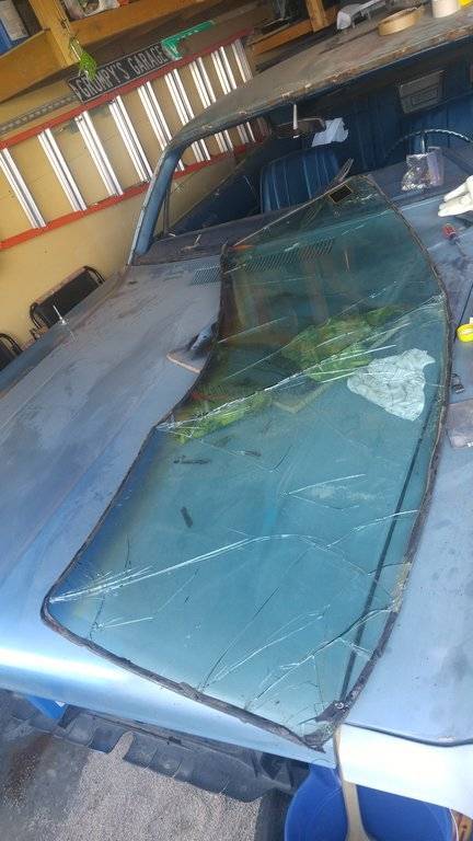

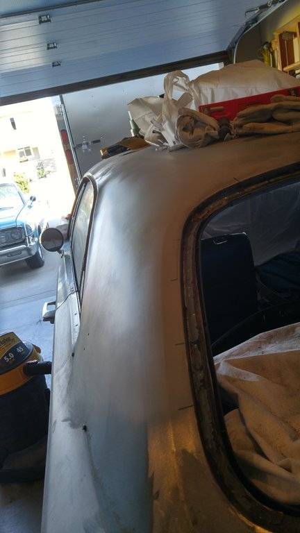

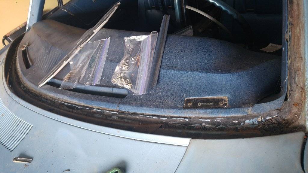

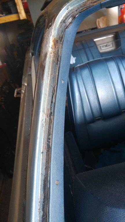

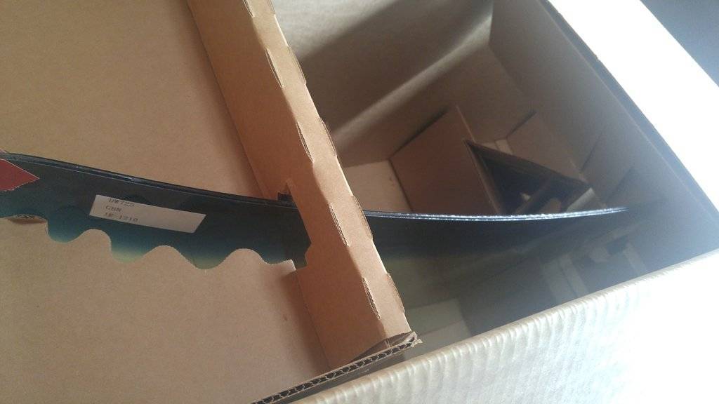

Now that the glass is in my possession, I can start working around the windshield and not worry if I chip or break it. New trim clips for the windshield and back glass mouldings should be here next week, too.
