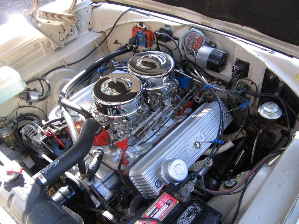

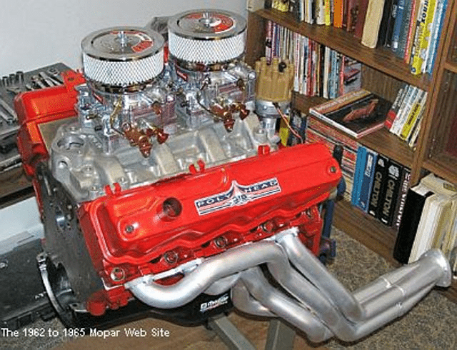

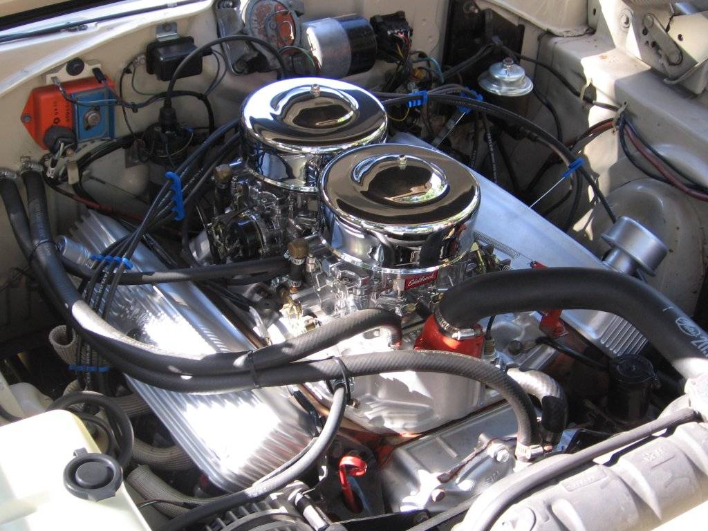

I realize the Poly is the displacement it is, BUT many have forgotten that its bloodlines go back to the "double-rockershaft" 1950s Chrysler V-8s. Namely, the original Hemi V-8. So "the bones" are there for power to be made.
Yes, some items are harder to find these days. BUT getting a modern-lobe cam, any 4bbl intake, and better exh manifolds/headers might well improve on what used to be around, back then.
At a cruise event, when somebody asks about the engine, just tell them it is a budget version of the Original Chrysler Hemi, just without the hemi heads, from Chrysler. THEN, if they know of which you speak, they will smile.
