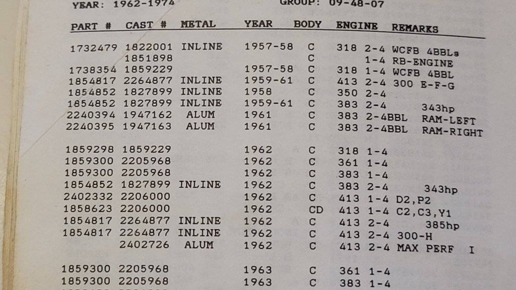

I see a single 4 barrel intake listed for 62 in my Galen parts book. #2205968 There was also an inline dual quad 383 with 343 hp. . 61 had an inline dual quad intake and a cross ram as well but no single 4 barrel.
