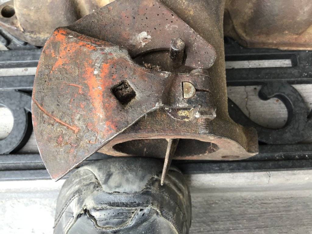

I recently acquired a 1966 Newport with the stock 383 2-barrel engine.
I noticed that the spring and counterweight are missing on the exhaust manifold heat riser mechanism. Does anyone know which way to turn it so that it stays open?
I found this thread, but there was never a definitive answer:
Chris
The person who started the thread also replied later, saying:
"My experience with exactly this problem is worth telling. What I had read about the 'open position' led me to believe that when the valve was rotated to where the notched plate stops at the pin (I think it was clockwise) that it was open. I made it stay that way and put down a couple of hundred miles until a manifold leak on the same side required that I replace the gasket. With the manifold off it was clear that I had the thing in the closed position. So, correcting that goof had stupendous results. The car seemed to gain at least 20% more power and run smoother than ever.
So it sounds like it’s not actually clockwise, but he doesn’t remember for sure. Someone tried to get clarification, but he never responded.
Chris
The weight is to be low when the valve inside is open. The thermo-spring pulls the weight up when it's cold, and relaxes when warm, so the weight drops (rotates actually, due to gravity), and in the process, the valve is opened inside the manifold.
New heat riser parts are available here: Dynamic Renovation - 1966-69 Big Block 440 383 Heat Riser Kit
