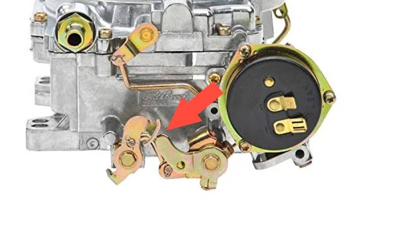

THERE IS A "thumb" on the carb linkage that press's the secondaries closed. some times it needs to be tweaked so that the "finger" on the primary forces that thumb up and holds the secondary closed tight.
you may have to hold the carb wide open (engine off) and bend that thumb so the finger press's it and seals the secondaries when you let go. back the idle screw off so that it gets done without hanging up on it then set it later and recheck that the thumb is held tight and butterflies are closed
Is there not a spring wound around the secondary throttle shaft to keep the secondaries closed? Usually is on Carters and similar, from what I've seen. Might be out of sight, but it's there.
IF the secondaries are cracked open more than a certain amount (as the Holley 4bbls are, as they have an idle system on the normal 4160s, to keep fuel in the secondary float bowl fresher, if the secondaries never open), the hot base idle speed will be affected by that minute bit of opening.

there is but I have been here before. just a suggestion.
you can also look down the carb when its idling and look if any drips are coming out the secondary venturi's
you can also grab that thumb at idle and try to twist it closed youself and see if you hear a change in idle.
sometimes the spring doesnt cut it.
