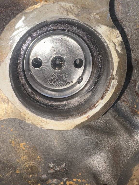

Maybe there is a better tool, but as far as 'reasonably' as is in use or price can vary.I can think of a number of methods for cutting cast iron to accommodate precise diameters, but on a slightly different note, I'm more interested in having the best tool reasonably available for inserting a Mopar B/RB engine's cam bearings. Much as I love UTG, I'm willing to pay a few extra $ to get things right the first time, and, having found this
Mopar Big Block 383 426 440 V8 Cam Bearing Installation Tool Removing Bearings
I wonder if any of you have used this tool, and if so, deem it worth the extra C-note to get it.
