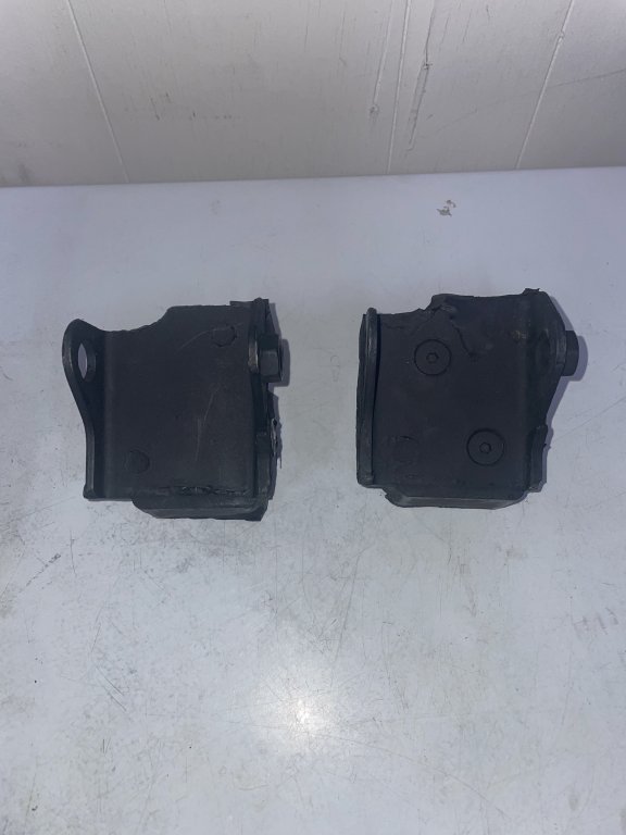

Very good point .. It’s not in great shape to be honest , intact but noticeably weathered . I have to pull the driveshaft to replace I joints so I’ll probably replace that while I’m down there . I’ll definitely report back on the Mity mounts down the road, assuming anyone’s interested in how they pan out.
Actually, the "Anchor" brand made in Korea as a cheap mount does very nicely, WITH the torque strap. Those rubber biscuits of the mid-1960s do fine for absorbing engine vibrations, unlike the synthetic stuff, and ALL of them will tear off on the driver side, if nothing restrains the engine from riding up. I used a length of chain before I bought the proper cable "strap."
