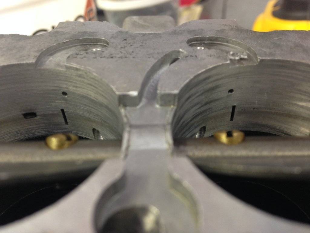

Take a piece of wire and run it in the round holes that would below the throttle plate. You should hit the end of a needle screw. I don't know of any carburetor manufacture that used an orifice to control fuel on the idle circuit. My bad Holley is the only one I can think of.

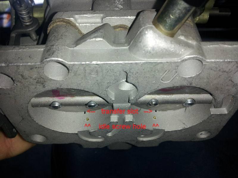

Saylor...I knew what holes to look for the air/fuel adjustment screws. That's why I said it "doesn't look like there's any adj. screws in there." Thank you for your photo. It's good to see one with the brass tips poking through. For the life of me, I can't understand why Ma Carter would fill these in with lead. Why did they NOT want technicians/owners to adjust air/fuel mixture to equalize both sides of carb and smooth out the idle? This is so frustrating!! I clicked on the link to your thread and read it through fairly well. Initially...I thought you HAD to put a manual choke on this carb...but now I see you CHOSE to. Thank you...it looks like this carb. is exactly what I want. But perhaps I can hold out for a parts carb. that has the proper base? I did just rebuild mine.

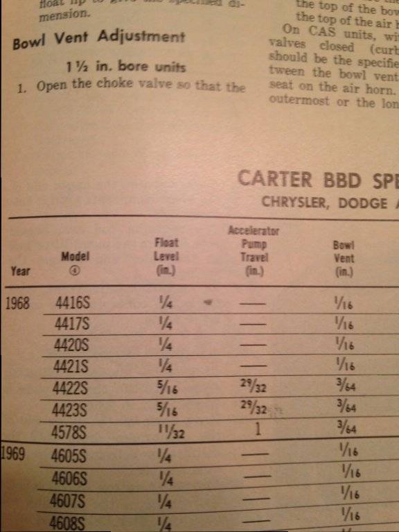

Photo below is of my Chilton's Manual. It lists several different numbers for 1968 Carter BBD 2 barrels, so there's 6 other original carbs. that may have adjustment screws? My carb. with the lead filled adjustment screw holes is the one at the bottom of list (for 68) 4578S.
