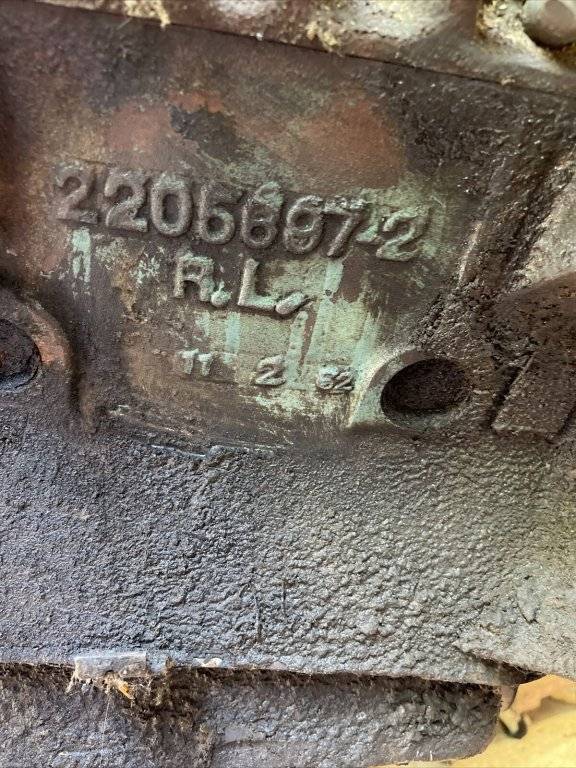

I will concur that you need to chase down the casting numbers and casting dates on your 413 block to verify what model year it really came from.

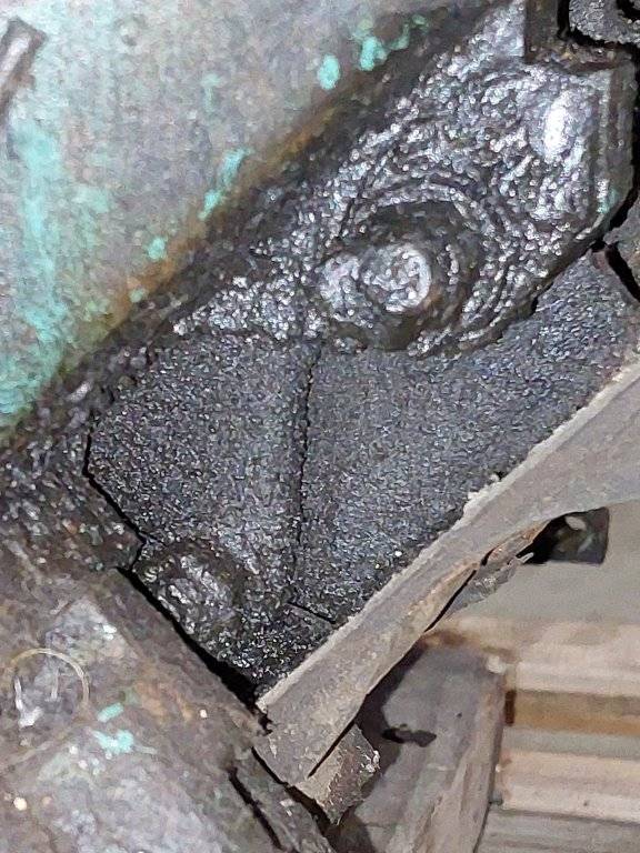

Here are some pix. BTW about the transmission fitment the seller told me it was a 6 flange block. I I have no clue as to what that is.

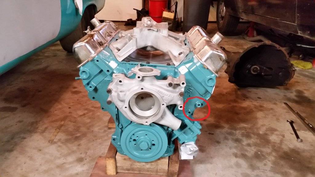

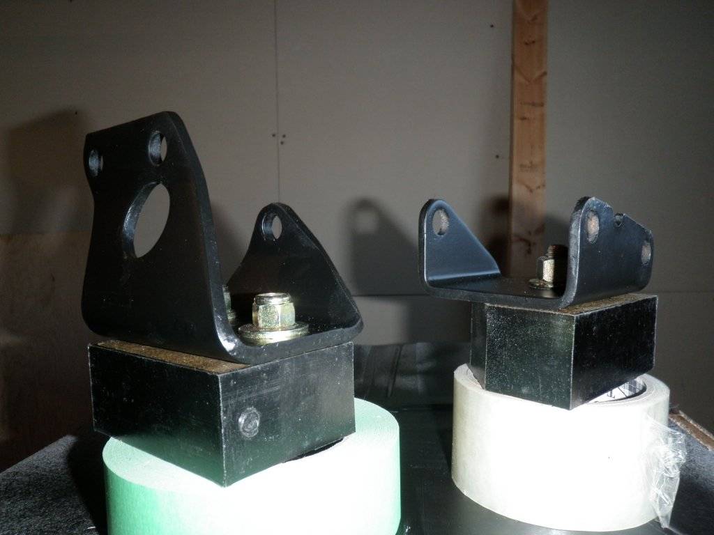

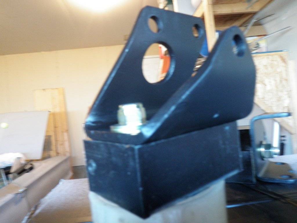

Now there is a 67 engine in there. You don't have just 1965 motor mounts any more. You will have some conversion setup so you may be missing some parts.
the block in post 21 does not have the bosses required for 65 motor mount.
So, Are there any options for the 413? Can i use the 383 motor mounts.

I'm not sure where things lie at this point. In post #27 you said the two motors have the same mounts I believe. In which case somebody has already figured out how to mount a standard block into the 65 stub frame assuming it's a 65 stub frame. If so, there is no issue use the mounts that are in the car.
As far as mods to the 383. You can put a 4 barrel intake on the 383 as it sits.
As far as building it up, check out the 383 recipe thread. I am building a 383 (also a 65) with info from that thread.
Additionally, I have recently learned that the threaded bosses show up years later on short deck motors so there could be even more options there. But between the two engines you have you are probably set.
Thank You! That is one less thing to worry about. I will proceed with the 413 then. That is quite a releif. Scott

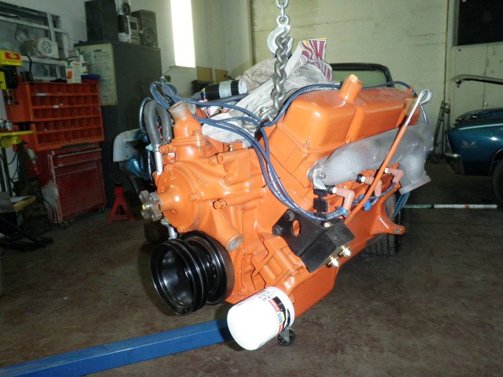

The oil pan will work. Make sure you use the pick-up that goes with the pan. The distributor will not work. The 413 is a taller block than the 383. The motor mounts should work too. 413's are RB engines and 383's are B engines. The intake manifolds are also different.
