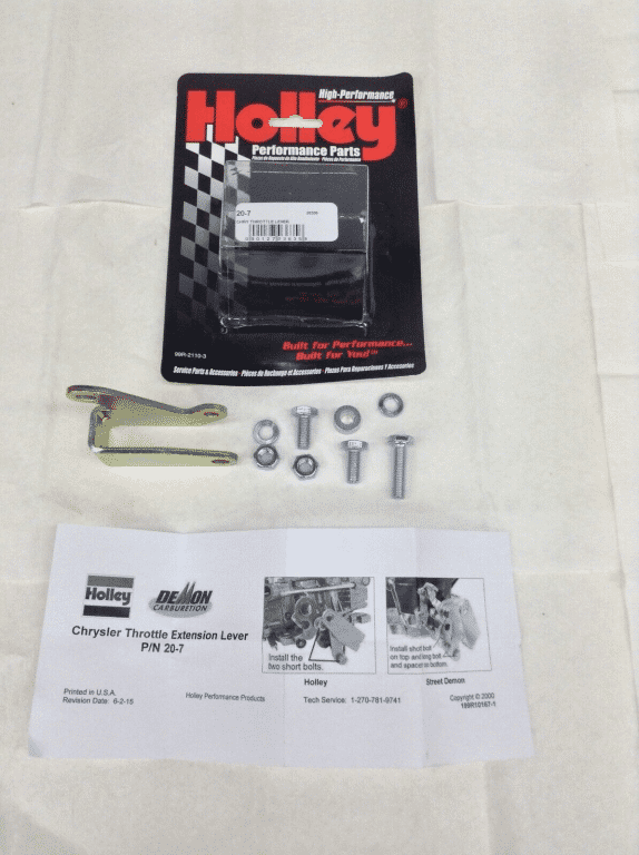

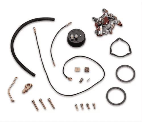

Maybe these?
HOLLEY 20-7 THROTTLE LEVER EXTENSION KICK DOWN BRACKET.
Holley Electric Choke Conversion Kit 45-223S.
If the carb is basically "aftermarket", then the above bracket kit is needed.
When I did such an upgrade on my '67 Newport 383 4bbl, I ALSO needed the kickdown rod extension item. I also had to use the thick insulator carb base gasket so keep the carb from being so close to the plenum floor, for better power. It all fits fine. I used the stock 4bbl air cleaner with no hood clearance issues.
For the kickdown rod, Edelbrock 8004 (7/16" rod) or Edelbrock 8003 (3/8" rod) is needed if the throttle is moved too far forward. You can probably ease the throttle cable forward and reuse it.
