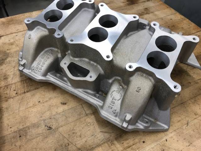

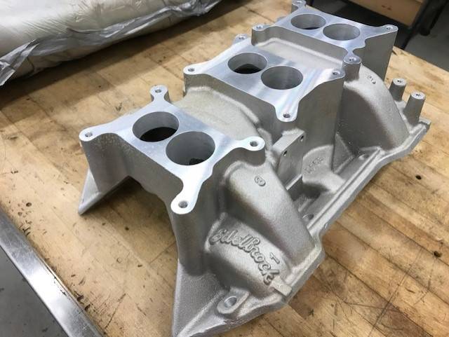

If you're looking for some "eye candy" that would work well on a 400 or a 383, here it is. I've had it for years and never used it. It's never been bolted to an engine, actually, if you're looking for a 383HP to go under it, I have those too.
The expense would be everything else to make this work, but it would be a great start!
