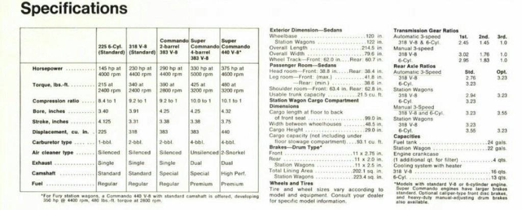

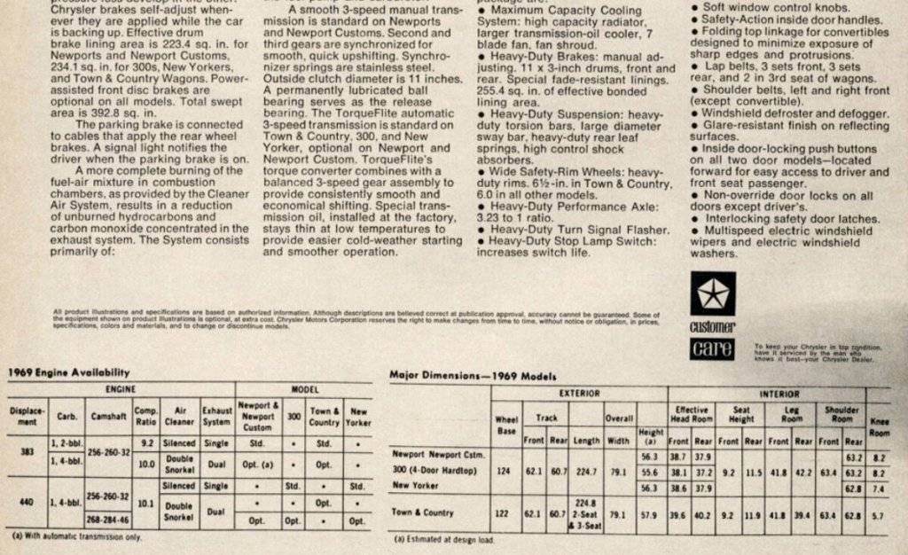

Correct....and on big blocks
Nope.
/6 and 318 on Furys
318 and 383 on Polaras.
383 on Newports.
But I will double check to make you happy. ☺️
EDIT

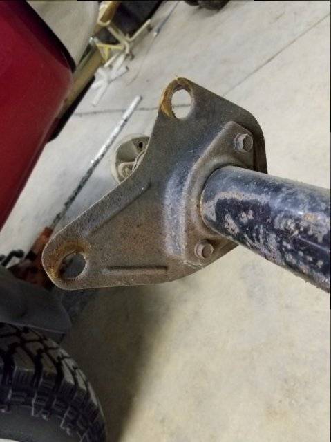

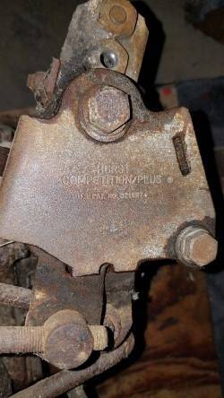

Well, here's for the Fury...
And the Polara...
And finally the Newport...

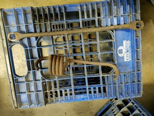

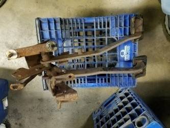

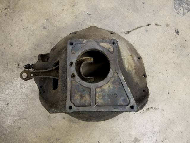

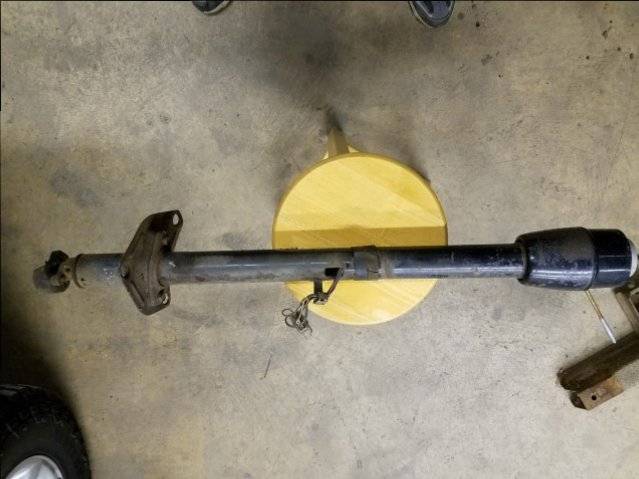

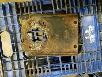

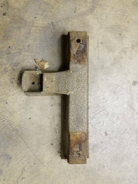

i'll get a pic of the car being parted out , thought he said a 66 fury 2 . heres pics of the parts . i get the frame z bar mount also .

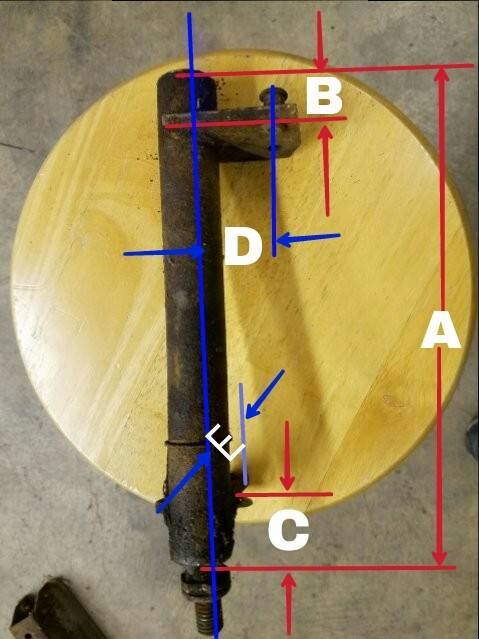

Measurements would be very much appreciated.
And how many degrees are B and C clocked apart. Looks a shade less than 90. An end on view would be perfect.
Not asking for much, am I. I'm writing a book. lol

As already stated above, 383 3 speed was optional on the Polara (318 standard) and in the Newport, and not available on the Fury (/6 ((std)) and 318 ((opt.)) only)
Never in history has there been a 3 speed 440 in passenger cars. 413's could be had with 3 speeds.
