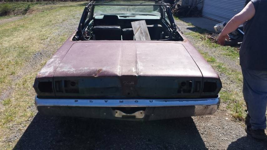

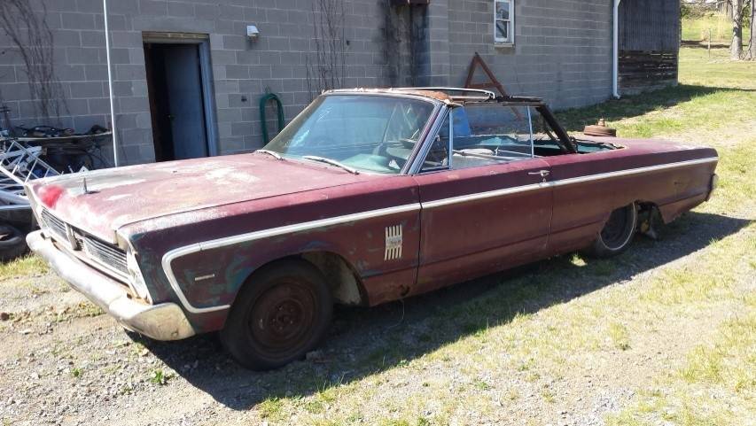

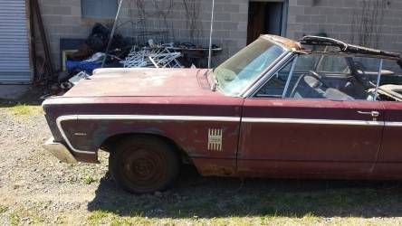

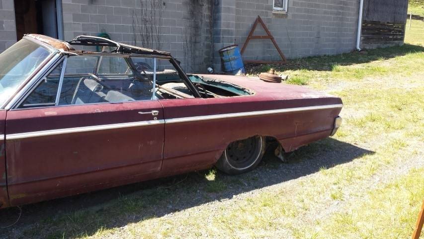

well guys n gals here are those pics of the 383 4spd donor car , said to say . it doesn't look that bad to part it out .
I know I've harped on several 300 'verts lately against them becoming parts cars, but this one I feel differently about. I personally wouldn't part it out, because I'd run from such a car, it's one you struggle to figure out what to do with it. IMO this one would be a mistake to try and save, even if it's a 4-speed car. That car is $7500 worth of work away from still being a POS.
From what I've watched of 4-speed Cs on ebay, the 'verts don't seem to have the draw of a 2dr in similar condition. You'd think they would, being rarer-than-rare, but bidders don't seem to agree.
i'm not a go with the flow kind a guy . but i agree c bodies don't bring the funds they should . even having the same options as there little a's b's n e's do .
