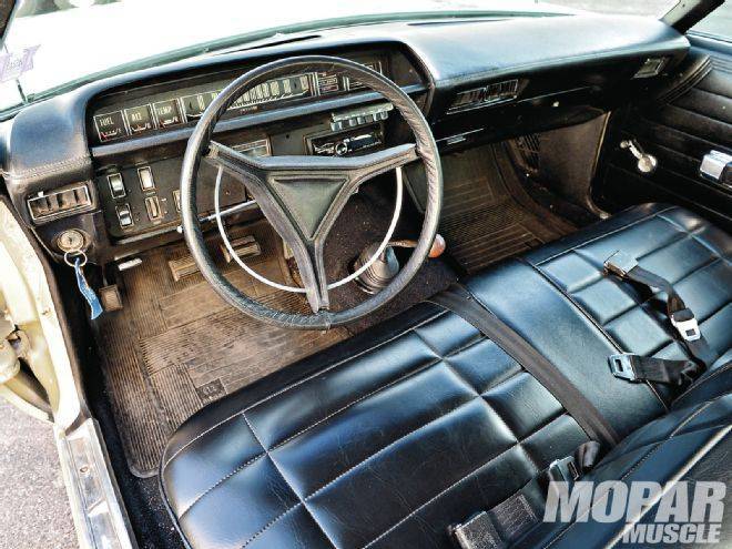

Here is the parts list for my 69 Polara:
10 1/2 aluminium bell housing (70-72) 130 tooth flywheel
made the frame side bracket
bought pedal assy, had the shaft coming to the z-bar
found an OE z-bar on the locator (at a dealer)
the fork and pivot is 64-65 b-body (I used Brewers website to see all the possible ones)
That put everything in line, I don't run an over-center spring, because I have a diagram style pressure plate
The tunnel was a repop, of a 65-68 c-body, and it only took a little playing with to make fit.
The carpet is kit for 4-speed c-body (showed 65-72 in the catalog), the only issue was the seat belt covers.
The shifter and trans is all b-body, direct fit
I used the stock cross member and mount, and driveshaft

Thanks, am just investigating and sharing. Am still basically a window shopper, whereas your good self has actually completed a conversion, and on a car that was NEVER optioned with a manual trans (no 3 on the Tree even), so I think you had a far harder time and had to be quite inventive I would imagine (?).
Ever think of a thread on that, teach us all how you did it? Pretty please?
Priceless. Sticky if we actually had any...
Are you talking about a the 4 speed into the NYB or my converting a Fury /6 3 on the column to a 440 4 spd?
The former. Did not previously know about the latter, that sounds VERY interesting, details please!
