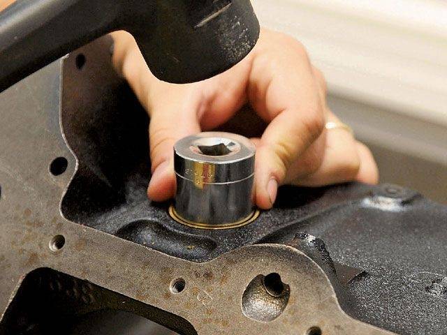

I spent 2 DAYS last weekend cleaning out an extremely corroded freeze plug behind the passenger side motor mount. Finally, an improvised sanding drum got the rust-welded remnant of the old steel plug out. Pounding a brass plug in that confined, awkward space just destroyed the brass plug, so I then ordered a Dorman 02483 copper expansion plug to fit in there. Your 440 plug looks like the EASY one just down from the motor mount, so I advise you to go ahead and drive in a nice BRASS plug, so you needn't worry about it for a good long time. If you prefer the Dorman expansion plug I got, that should be fine too.

I replaced the very plug you pictured back in 2005 on my '66 New Yorker's 440 in under 40 minutes. The middle plugs are pretty easy. The back plugs, not quite so as you must remove the starter on the driver side, and the exhaust on the passenger side. Might as well do your motor mounts for the front plugs, or check the plugs if you're doing your motor mounts.

Got it repaired. Ended up using the rubber expansion plugs. I tried to do it right with a freeze plug tool and actual freeze plugs... But after 3 hours and multiple trips to the parts store I gave in. I figured the rubber ones will suffice until I pull the motor. It took me about 3 minutes to replace with a rubber one and no leaks ...yet anyway. Thanks to all who have input on this thread. Very helpful.
Get the copper expansion plugs, the Dorman 02483 when you can, and when your rubber stoppers fail, use those to replace them. I used a rubber one recently too on the driver side, just to hold for a couple daze... Worked fine for that. I've seen pretty good reviews of the copper expansion plugs, including one at this forum somewhere.
