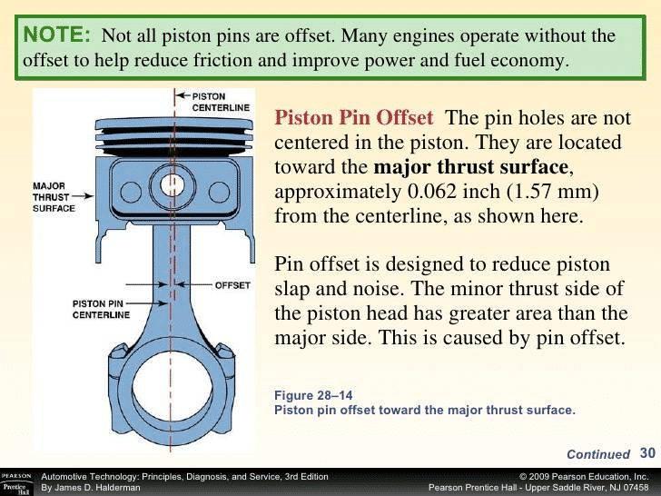

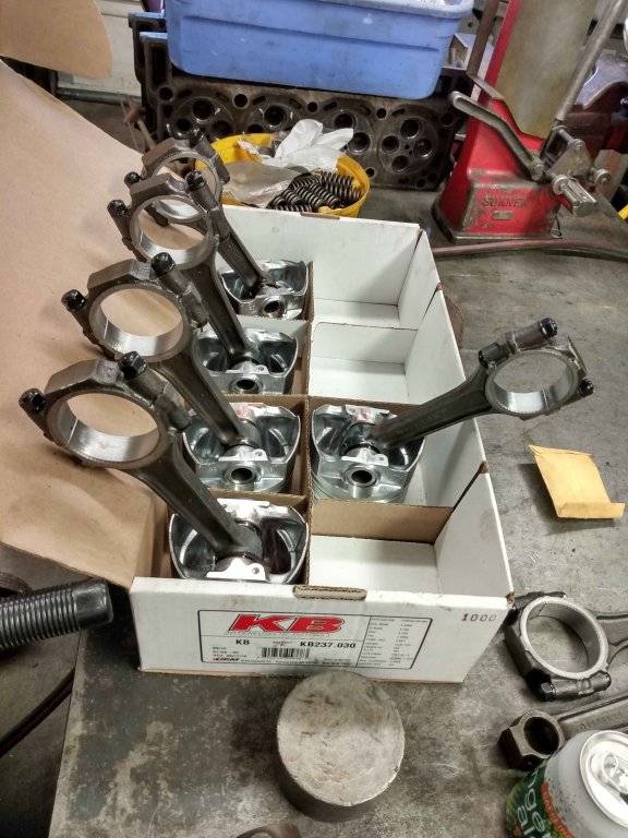

Skirt is offset from the wrist pin/piston pin 90°.
Skirt wear may happen when there isn't enough clearance between piston and cylinder wall.
Or the piston got too big from overheating.
Or the piston is installed backwards, so the wrist pin and connecting rod offset is wrong. That makes a sound called piston slap, a sound that changes as load changes.
Regardless, the pistons need to come out. You'll have to measure the pistons and the cylinders to verify clearances. @Toolmanmike provided this pic in another thread.
