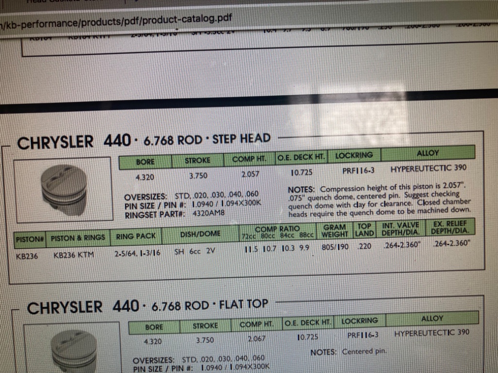

My only real goal is to attain 300H engine performance for my ‘62 300 Sport. A piston swap to the KB domes will achieve 10.0CR. Add the cam and intake I listed above and the horsepower should easily be there to match the dual quad 413 even with stock exhaust manifolds. (it won’t have the cool factor, however!)

The specs in KB catalog show the compression height at 2.057, should work out to about .024 in the hole. With a 440 source stainless steel shim gasket @ .017 That calculates to 10.0 CR. Not quite the goal, but I would call that good enough. I would much prefer the thinner rings but for the car this is going in, i’m willing to sacrifice that 20 horsepower. I have not compared side-by-side weights, but I would be very surprised if KB were heavier than the stock cast flat top. I’ll check into it and let you know.
