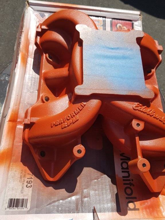

Pic of the Airgap
Performer RPM Big Block Chrysler RB Intake Manifold

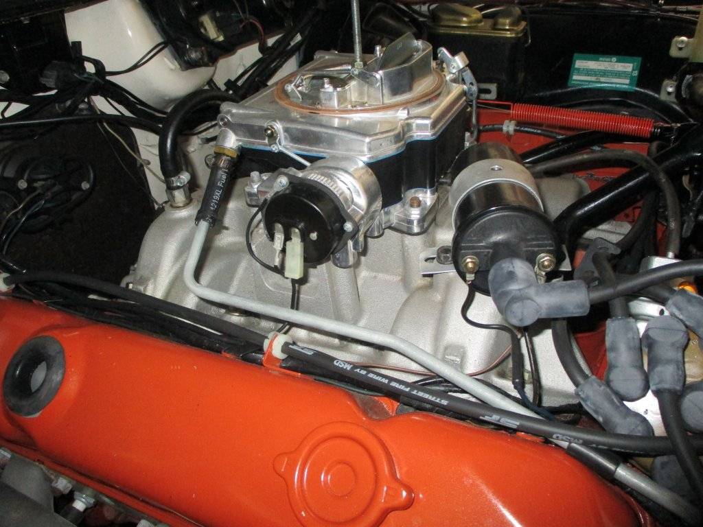

I use that manifold on my 440 and I like it.

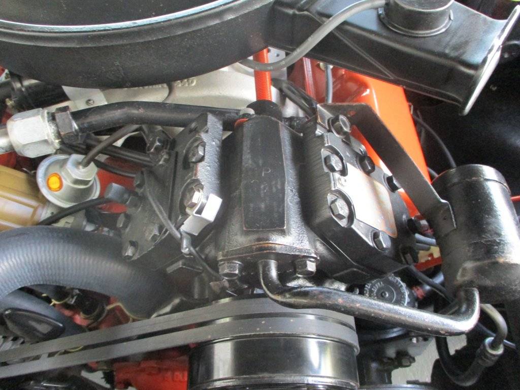

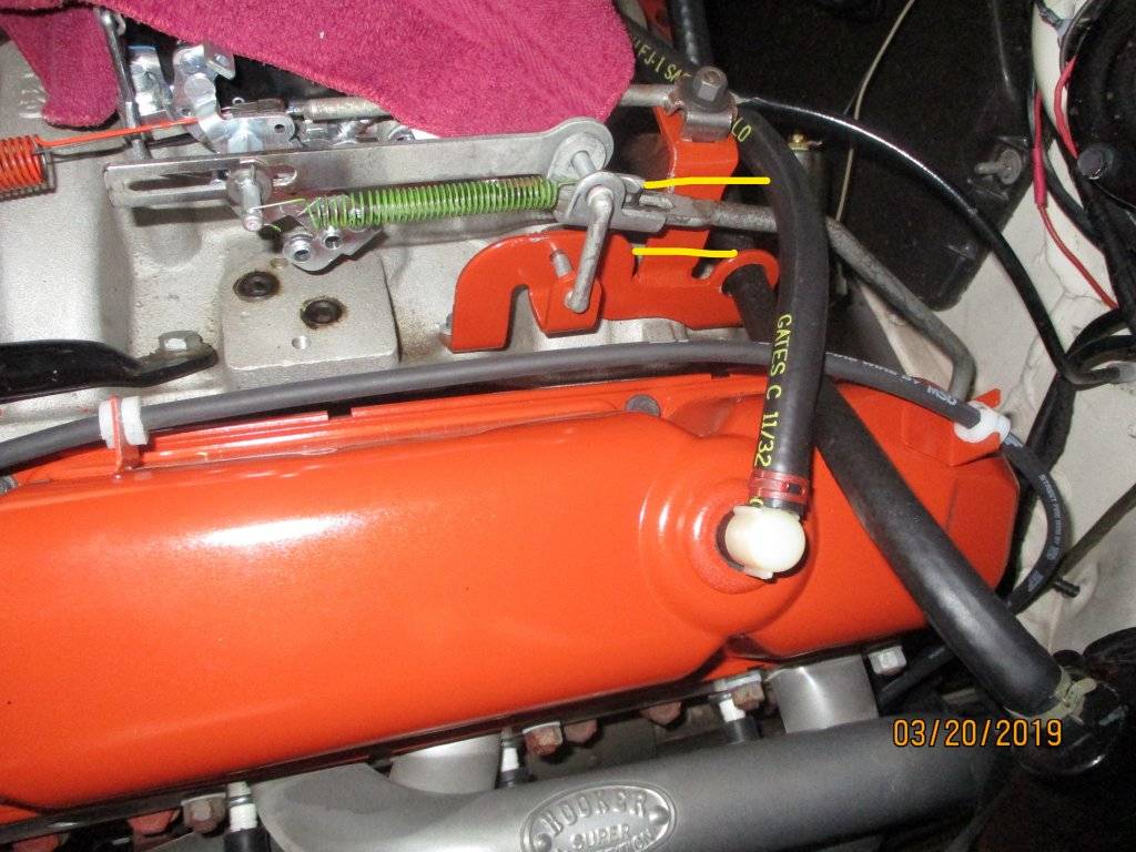

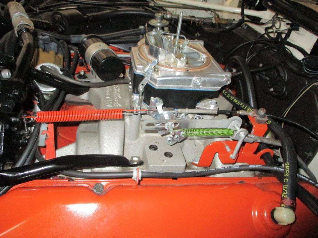

However, there is an important issue that you must be aware of. The carb will be about 1.5 inches higher than stock, and if you have a carb where the cable connection is somewhat high on the carb, like my Street Demon, you'll have an alignment issue (and possibly a hood issue). To raise the cable, I cut the stock bracket and added an appropriate piece of bar stock, about 1.5" long, as you can see in the pic below.
You can see the straight shot the cable has to the linkage in this pic.

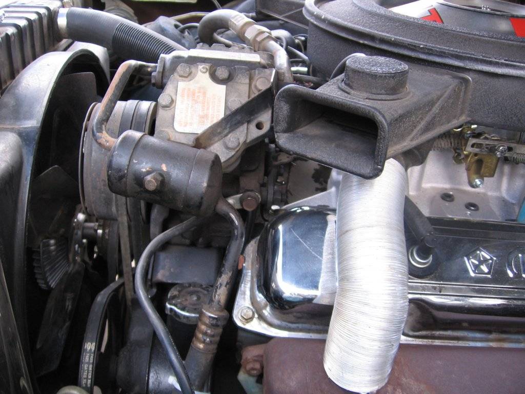

@Trace 300 Hurst did you have to modify anything to get your compressor to fit? Using the Performer I take with factory A/C.
I thought it was an improved version of the 4BDP (or whatever the original copy was). It may be taller, but I thought it was basically the same thing.
The compressor bracketry is OEM. No issues. But in the second pic notice the tall screw that I had to install at the back of the compressor for the throttle return springs. Again, that's to get good alignment with the high attachment point on the linkage.

You'll notice that the top bracket, from the compressor to the intake, is missing on my car. It would not fit when I added the Eddy. I had no problem with the throttle spring.
