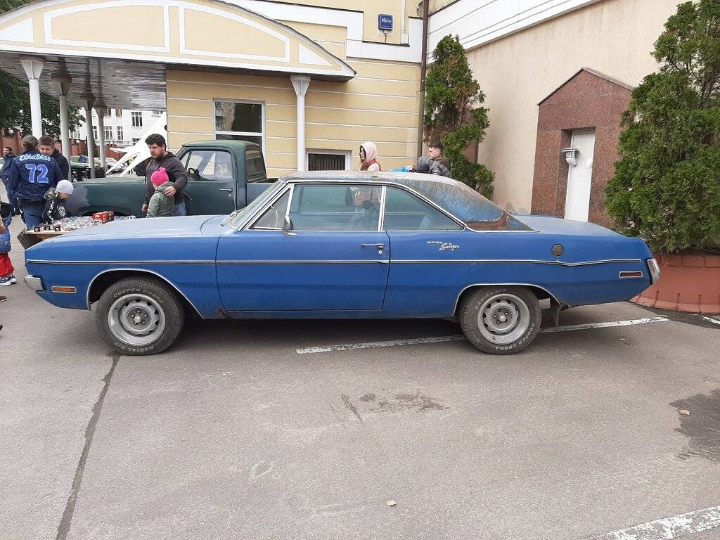

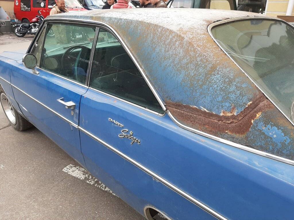

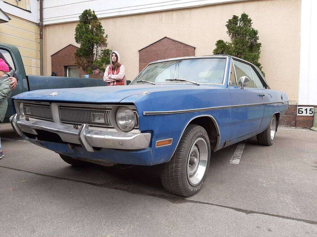

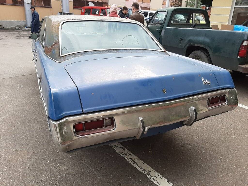

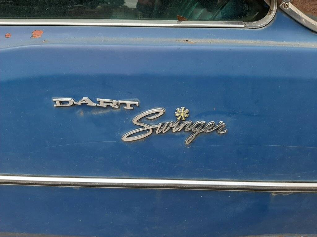

Hi! Yes, I got everything, I look at the photos. :thumbsup:Your Dodge Dart in perfect condition. Recently, a Dart was found in Russia, in the photo. For us, this is an excellent condition.:BangHead: It have 318 motor. Restoration will begin soon, there are only 2 of them in Russia.
