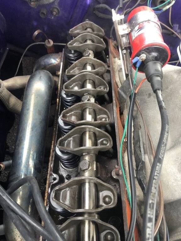

Decided to pull the covers. After priming the engine and cranking her up for the first time I’m getting oil through the drivers side heads but nothing through the passenger. Have good oil pressure and increased RPM to see if oil would make its way there but nothing. Decided to shut down.
Is there any reason Oil would feed to one of the heads and not the others?
In theory cam bearing could slip out of alignment.
You didn't have the rockers off correct?
If you did remove the rockers the shaft could have gotten installed incorrectly and the hole in the shaft may be in the wrong place. Easy check for that.
I have not had the rockers off, but I cannot speak for the PO which I received it from. @Polara_500 How would I go about checking the correct/incorrect positioning of the shaft? I may look through my FSM tonight
