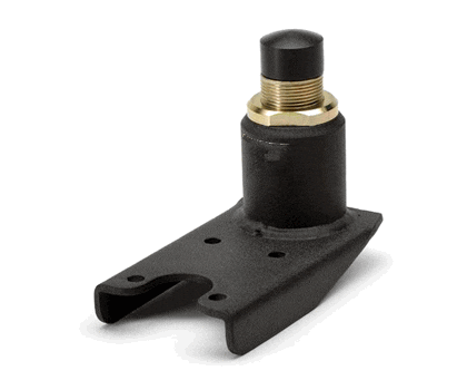

That axle should be able to handle the 6.4L power. You might want to add an adjustable pinion snubber to limit the travel of the pinion end of the 3rd member.
https://www.manciniracing.com/newpr834adpi.html
