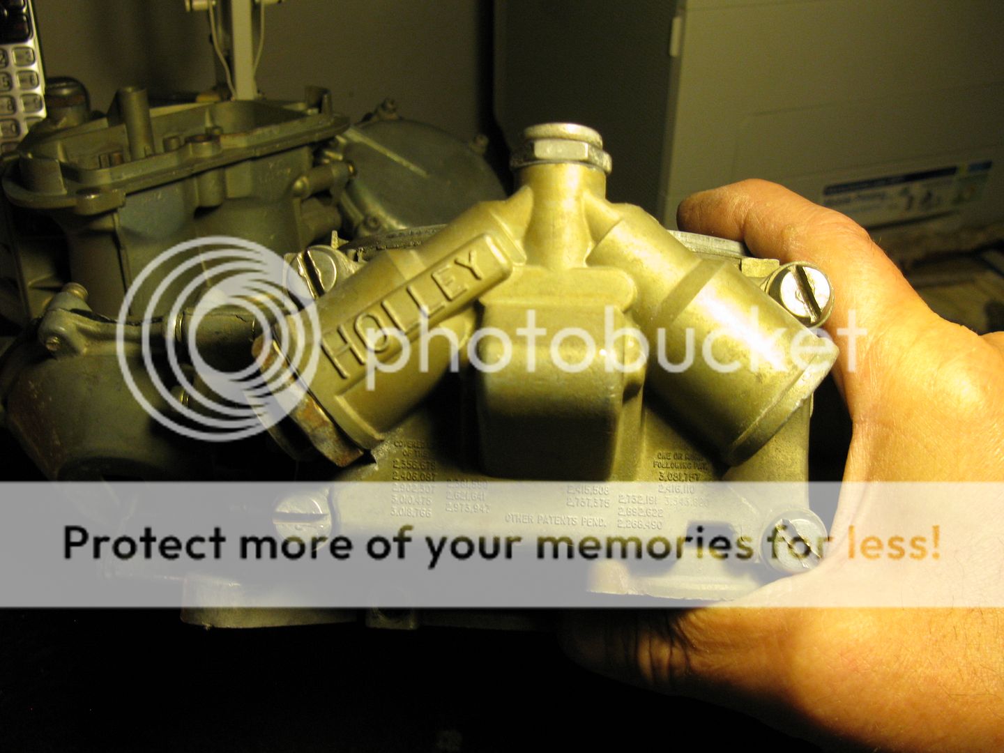

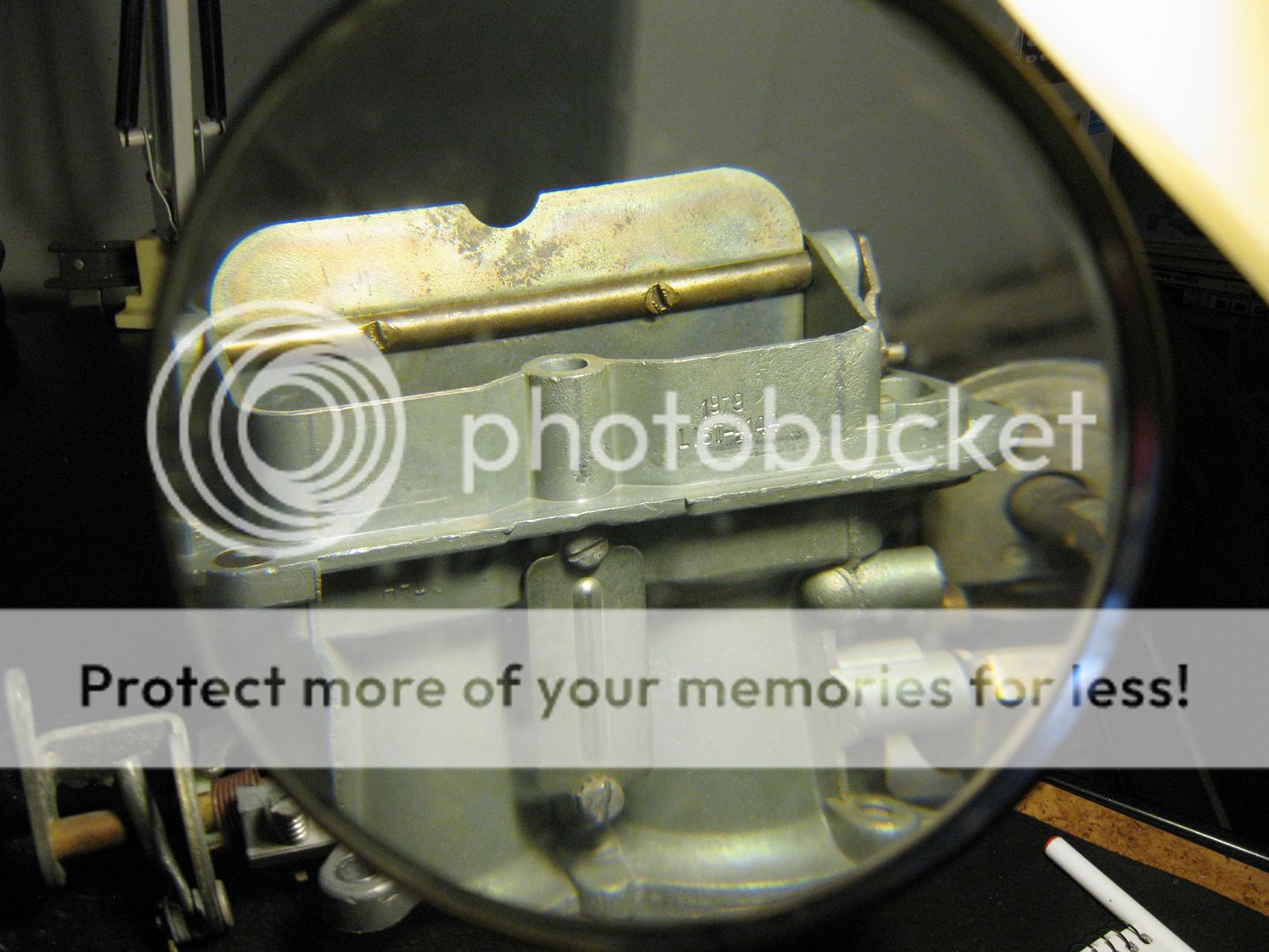

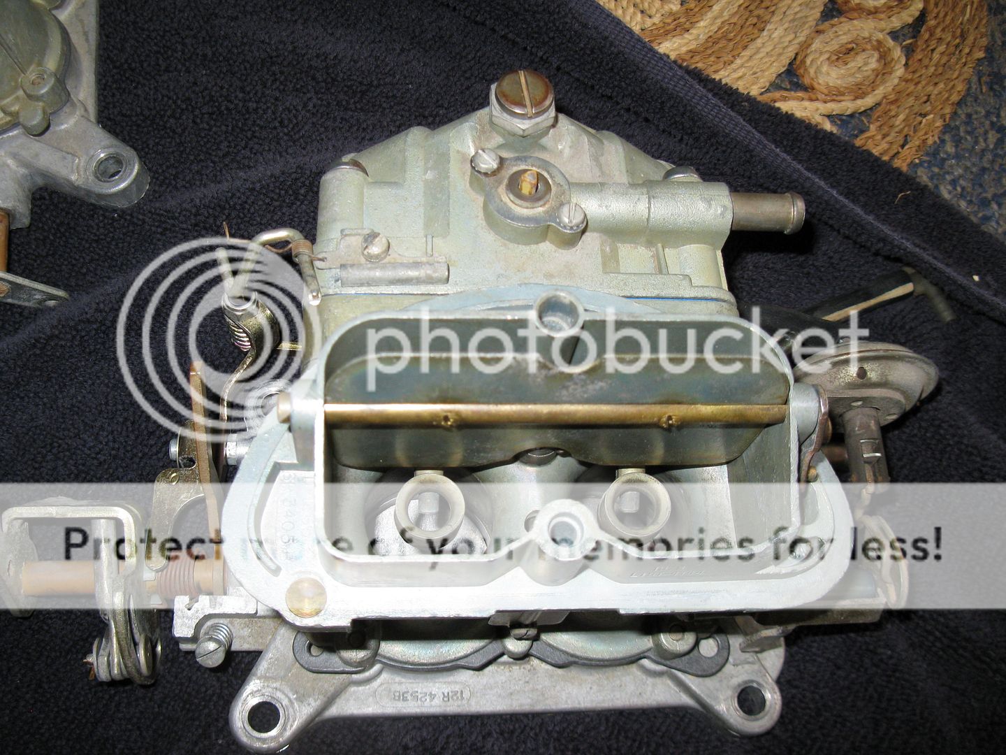

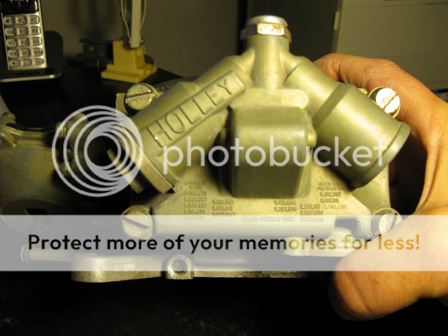

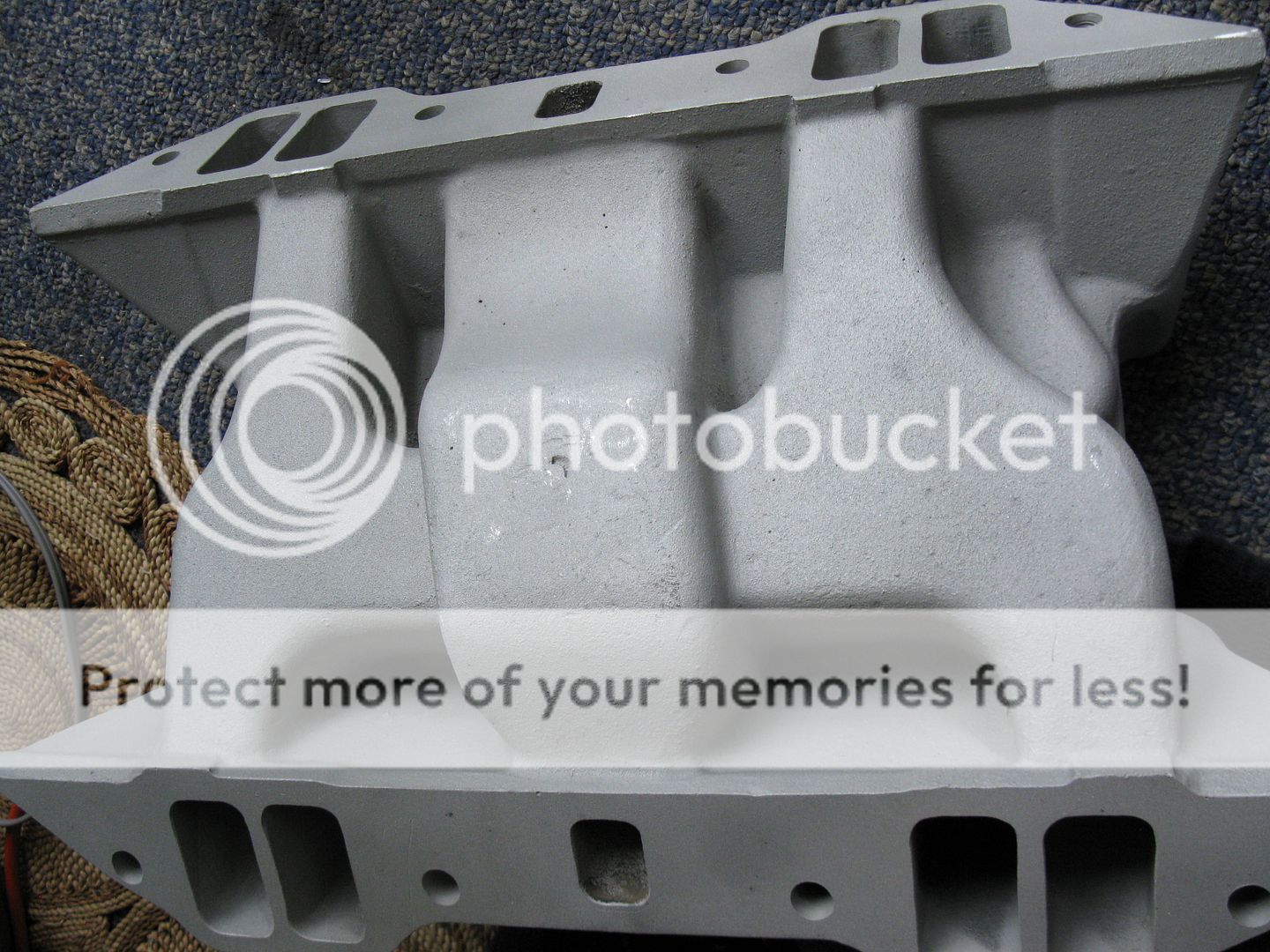

know intake isn't a repop but that's just a assumption on what lve been told...can sort this out right now..hate guessing..have darn thing in liveingroom beside me...will grab some pics and we'll sort this out..give me 30

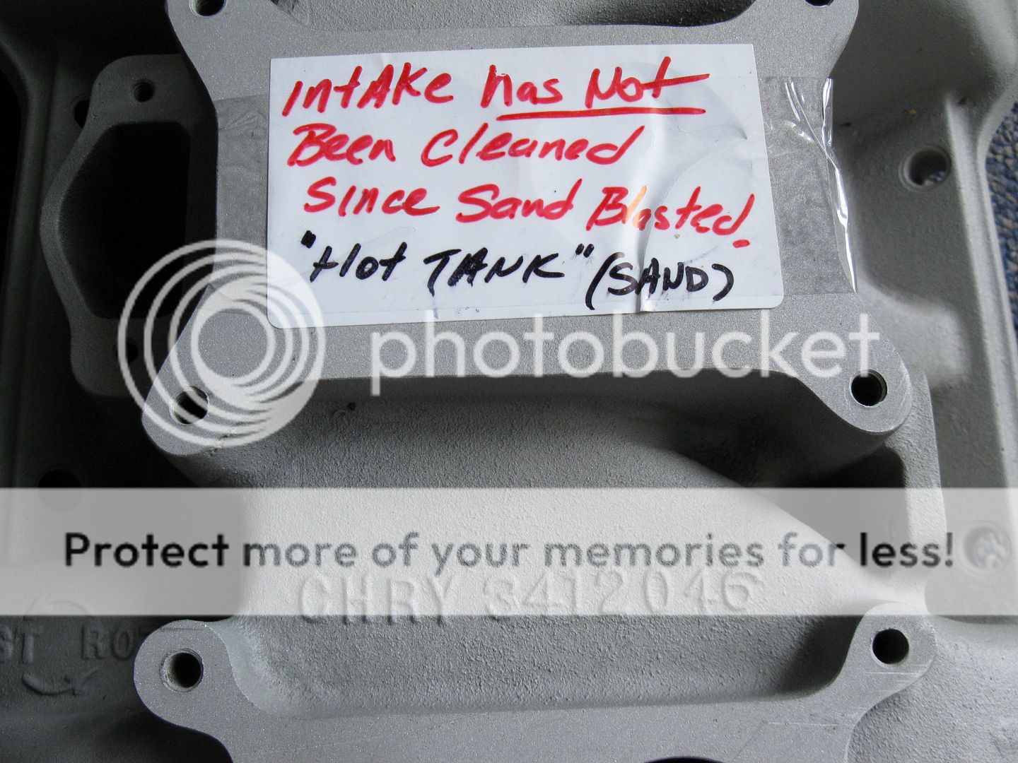

note..intake was blasted to clean it up..was pretty dirty when l got it

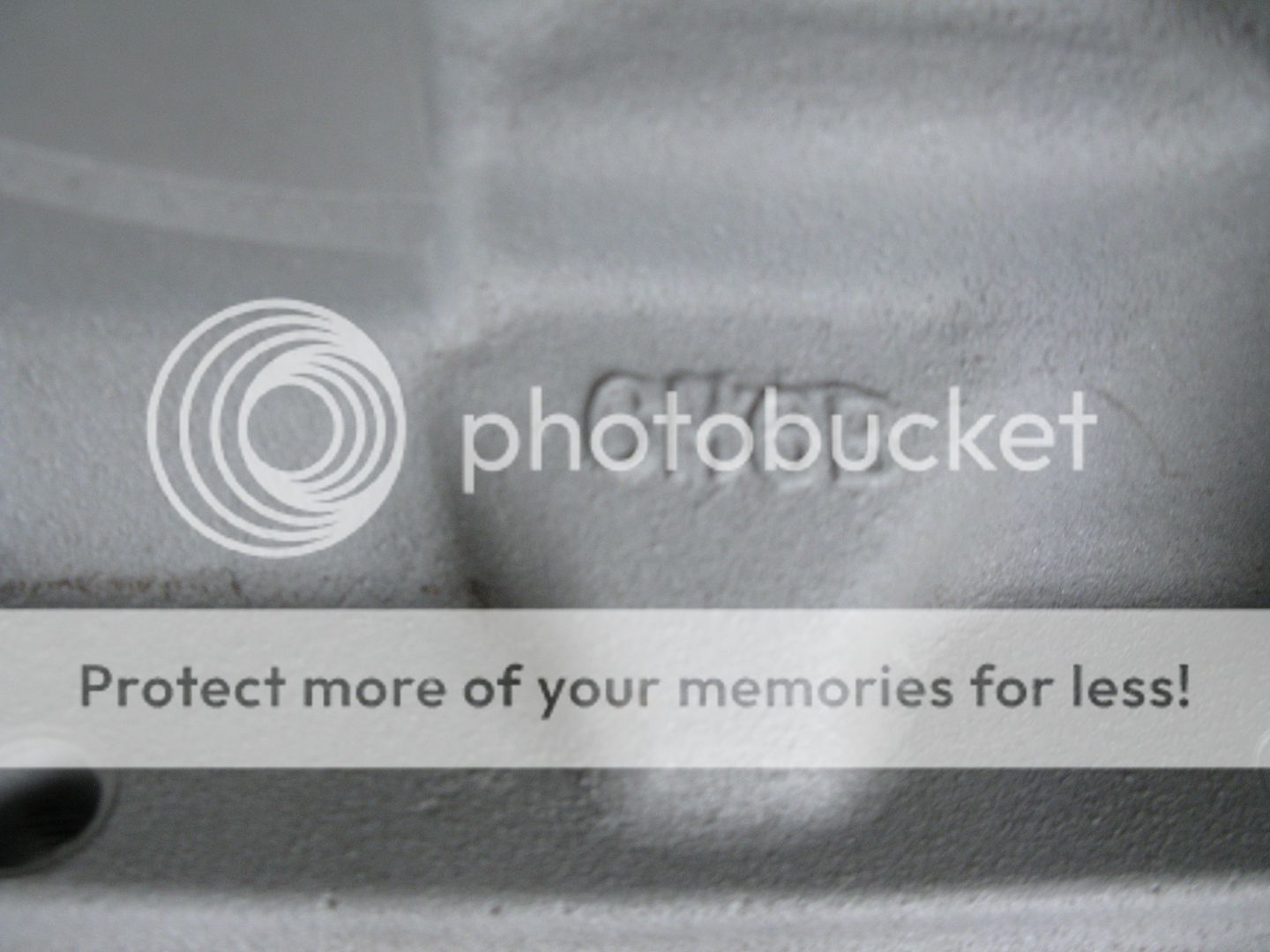

k here we go..pics first then what numbers l could see...
most nos can be seen on intake...carbs to follow
Numbers...no clue so bear with me

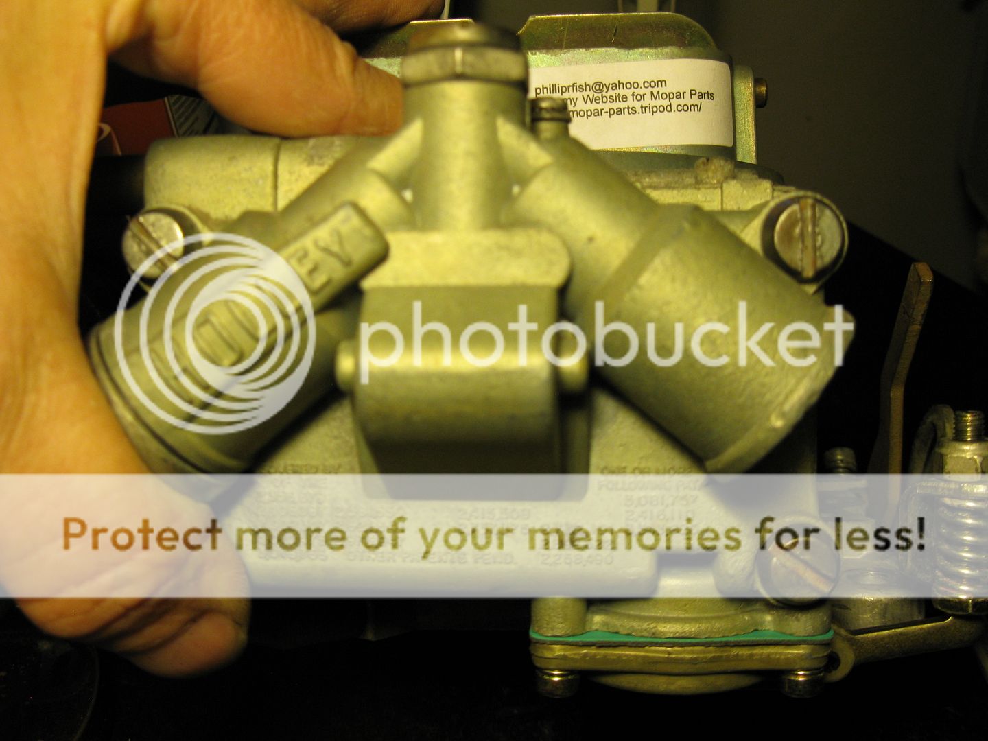

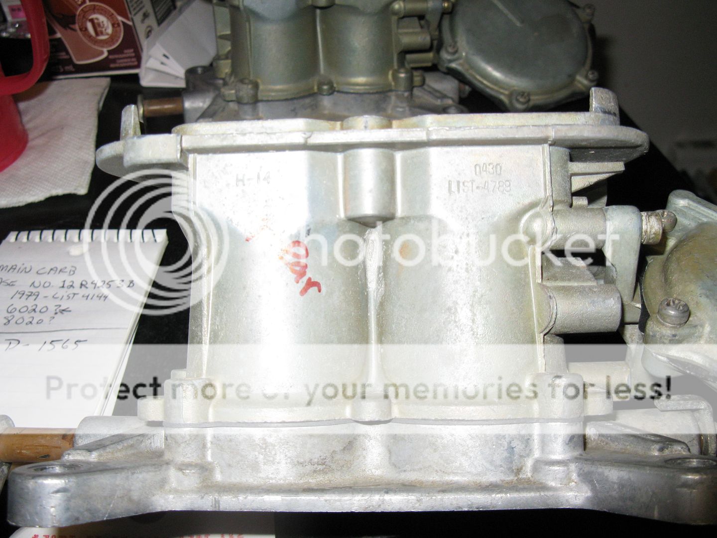

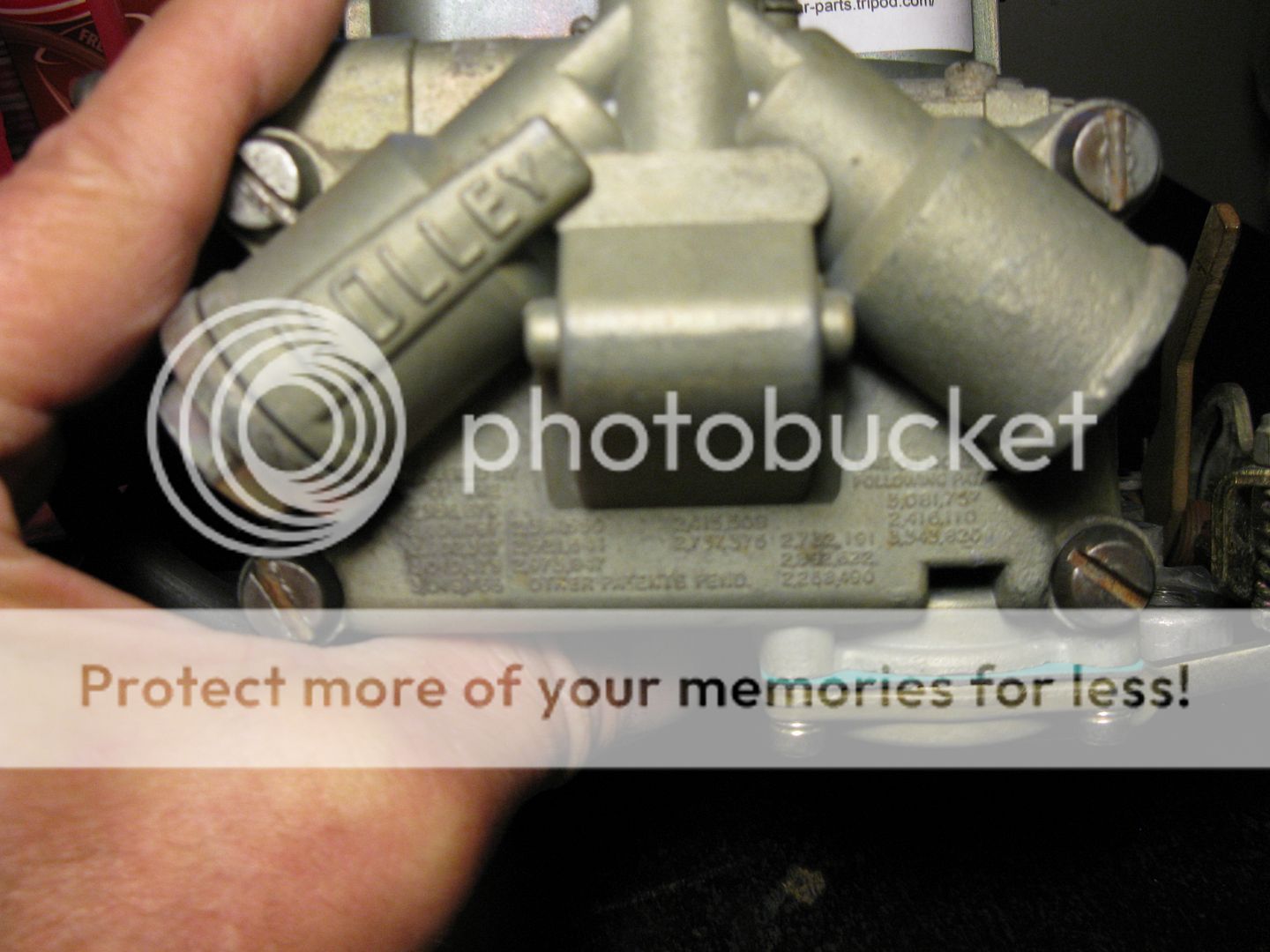

front carb
h-14
2679 list 4382
base 12R-42548
top D-1565 6R3406B
main
base- 12R4253B
top 1979-list 4144
6020 or 8020 not shure but belive 6020
Rear carb
D1565
H-14
0430
list 4789
6R-3406B
base 12R 4254
k done any help sortin this out greatly appieciated...know builder had to replace one carb due to crack in housing and found one that would work..wether its date compliant to rest have no idea...still learnin..bear with me
71 center carb. You can tell by the fuel vent.
hmmm 71 aye...seems l just happen to have a 71 car for it...dang it..the gods are taunting me...realy wish the voices would go away....thanx kindly John that's a start
The CH6B indicates an original OEM manifold. I don't think any of the aftermarket units were cast with that.
Carefull check the bottom of the intake below the center carb, (heat crossover area) for cracks. It was a known service issue.
