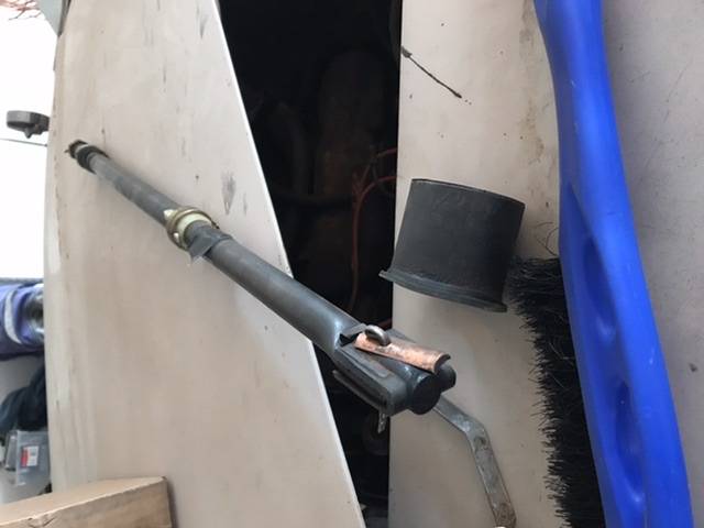

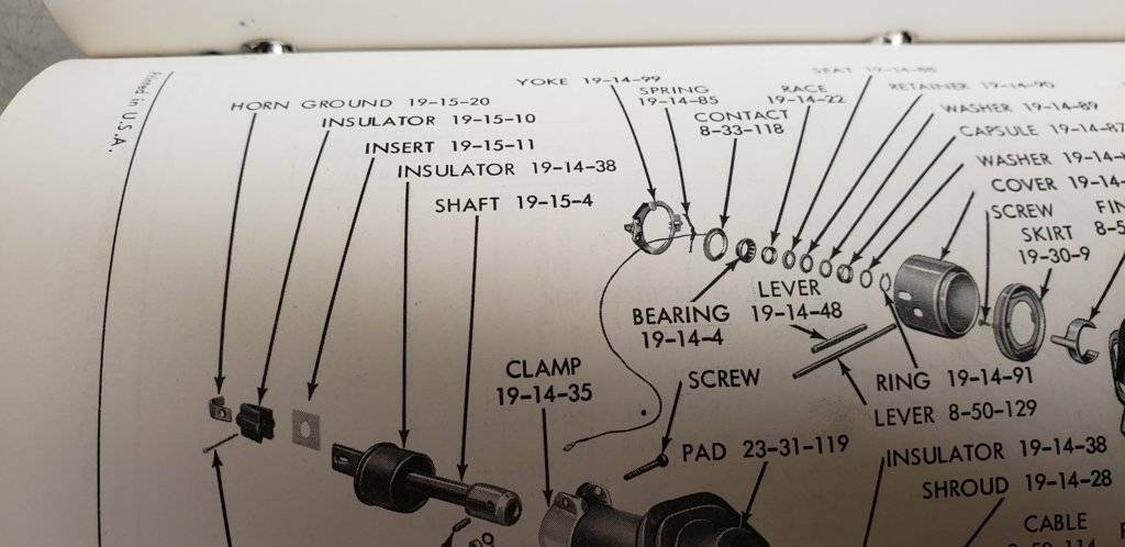

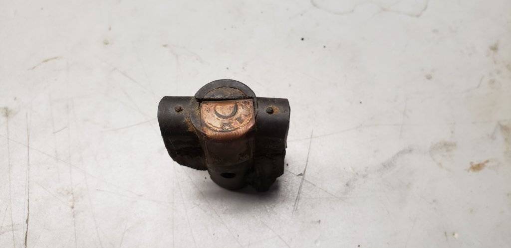

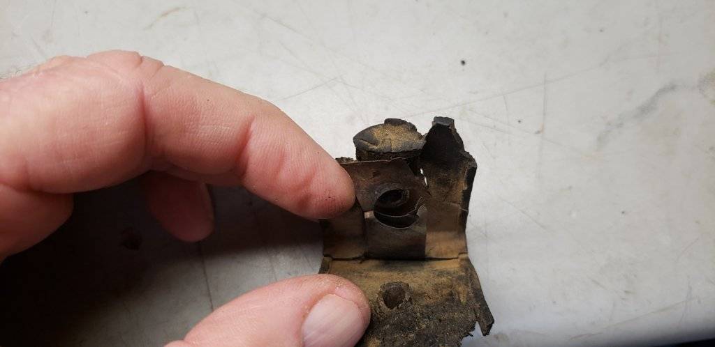

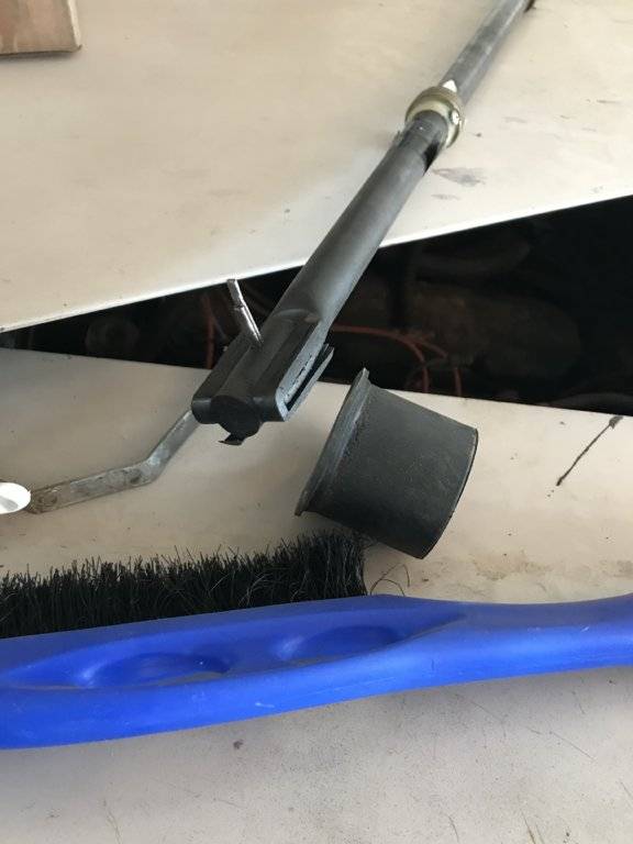

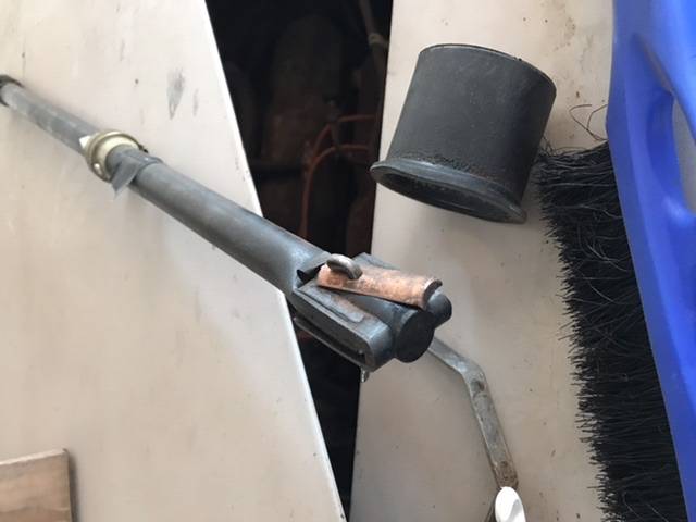

Thank you your help. I am sending a couple of picture ( which I should have done to start). I think this is different from the horn. Thoughts...
It is Absolutely for the horn to function. Nothing else. Make one, nobody will see it as everything is enclosed on these cars.
Holy cow! That is an awesome diagram and makes sense from all the posts. The copper piece only goes down one side so...soldering the copper piece should work. Thank you all for the help. What an awesome group.
It has to go thru the rubber to touch the inside of the shaft, to compete the ground circuit.
