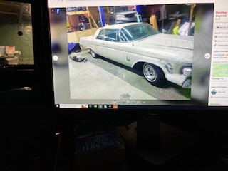

hello car sat for a while the 413 cranks fires up runs briefly wont accelerate at all good spark fuel etc i bypassed the ballst resistor and it ran great for a second and then back to the hard starting long cranking , its making me crazy !!! Could the muffler be clogged? im ready to sell it! Thanks
