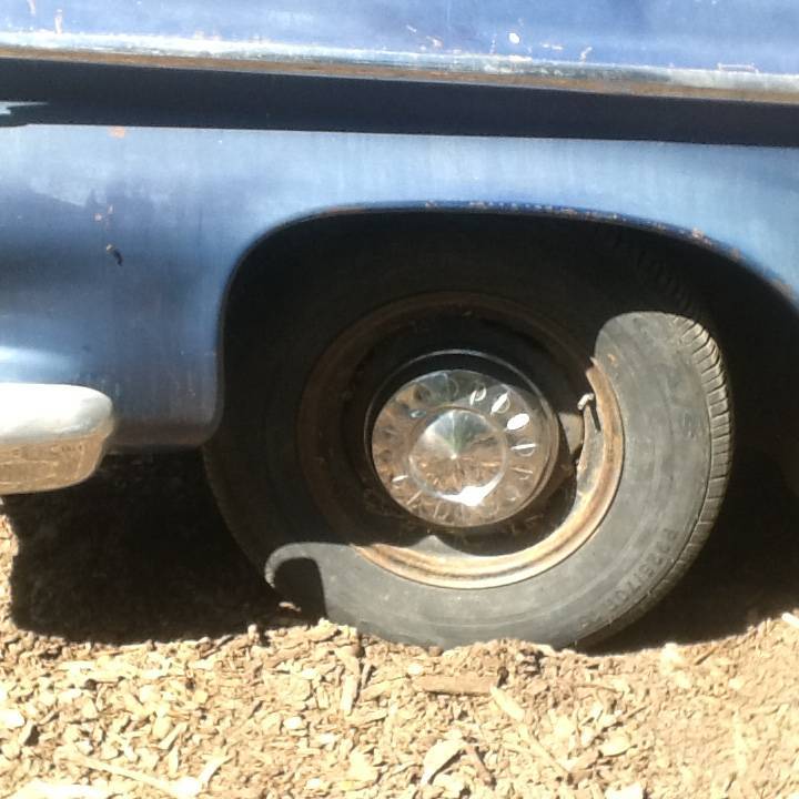

4 little nubs equidistant around the outer edge of the rim as in the picture.
Most likely off an early 60's Chrysler... 14"
If anyone has 2 or even one of these layin around, it will be an easy sale.
NO NUBS = No Good for 62 anyway.
If I’m reading your post correctly your looking for a 14in Mopar rim that will clear disc calipers and be able to use a 10in dog dish or 14in full wheel cover??
I’ve tried 70s 14in disc rally’s wheels and 14in aspen wheels and won’t clear calipers.
I don’t think the rims your looking for exist?
I’ve found that early 60s 15in dodge truck rims will accept 10 inch dog dish hubcaps but may not clear disc calipers
I think there is a repop rim that is made for this application
This rim is 15in that fits 10in cap
Came from early 60s dodge truck
