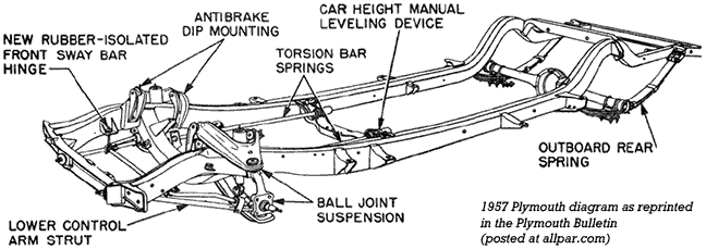

Attached is a pre '65 front suspension with rear tension mount torsion bar suspension with a front stabilizer. (Stabilizer stayed mostly the same)
The '65 and later units also ran a stabilizer link to a frame bracket mounted on the inside of the frame rails. You would need to weld the appropriate frame brackets to make the later style stabilizer work.

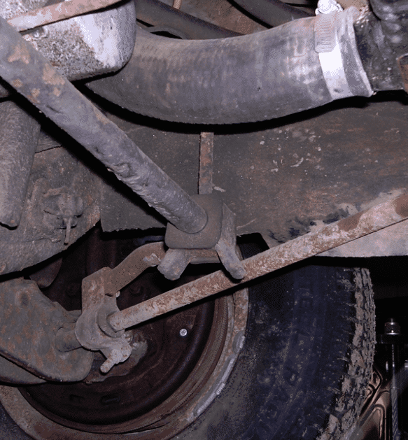

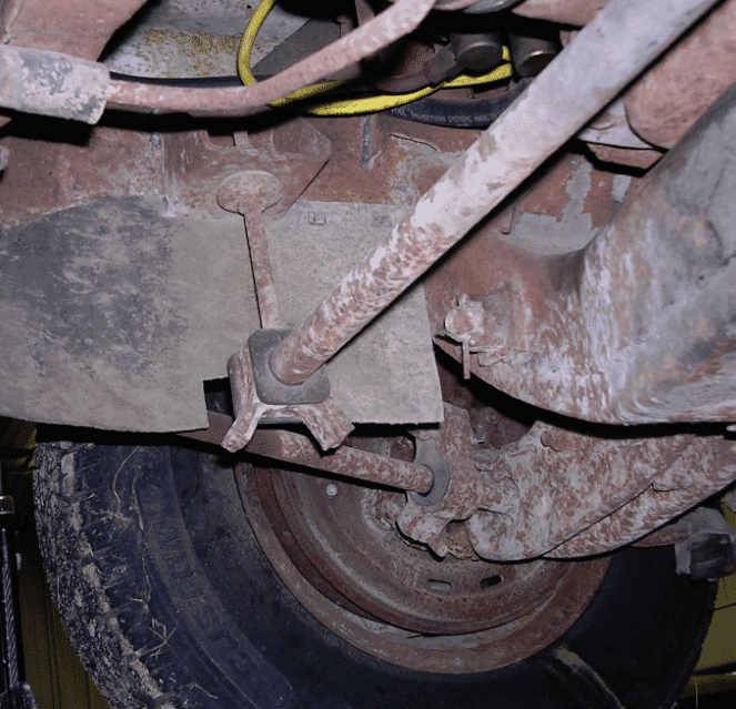

This one's kinda cruddy, but shows the psgr side sway bar frame mount and clamp.
Driver's side is a little clearer on the clamp area.
If you can't find one closer, I have a couple, but they're all in snow banks here in Northern Minniesnowta.

Thank you very much for the help. Gives me an idea of what I'm looking at how it works.

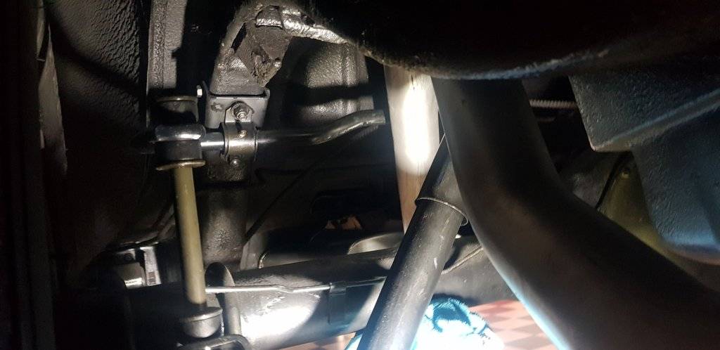

My 1970 Chrysler 300 has a brand new rear swaybar, that helps to go around the corner....
BTW, I replaced the front sway bar with a thicker 1 " one, the 2.2 ton car handles now like a rally car :lol:

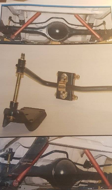

I got my front and rear end swaybar from Firm Feel, in Vancouver, WA.
You solve with this new stuff also the problem with the very hard to get rubber bushing in the front bar!
On ebay I paid $ 100 for those NOS bushings.
Yes, the sway bar is build with the car specific, it slides in without any addidional work. The rear sway bar is also a exact replacement for the Mopar NOS part.
They have an excellent customer support, quick delivery and their products are class A!
