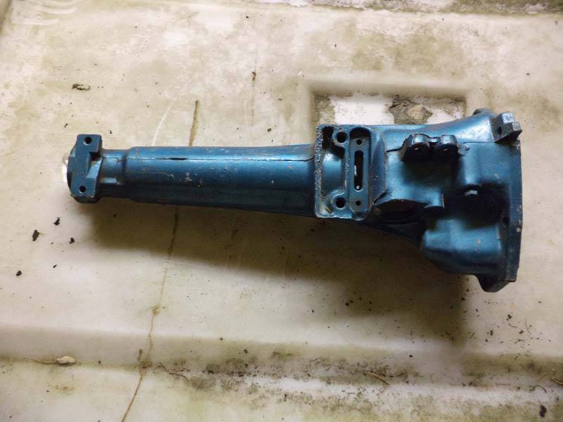

I found a picture on the internet that hopefully shows the area that I'm talking about. (I am proud of myself for figuring out how to save internet pictures). This is NOT my exact tail shaft but for illustration purposes it will work. The area I'm looking at is the oval hole. The service manual says that there is a gasket under that plate (not pictured). To access this you must remove the mount (the two larger holes). To remove the mount, the cross member must come out. For that to happen, the torsion bar mount (bolts to the cross member must be removed). I hope that a picture is worth a thousand words. Thanks to all Omni

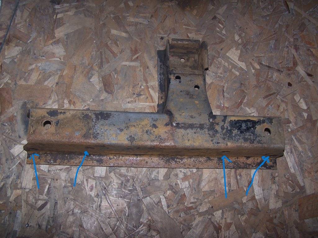

It has been a long time since I swapped a transmission in my 65 Sport Fury but I know I didn't touch the torsion bars. Here is a pic of a spare cross member I have. The blue arrows point to the bolt holes. I think if you put a jack under the tail shaft, remove those four bolts and drop the cross member, you should have access to you leak.

I found a picture on the internet that hopefully shows the area that I'm talking about. (I am proud of myself for figuring out how to save internet pictures). This is NOT my exact tail shaft but for illustration purposes it will work. The area I'm looking at is the oval hole. The service manual says that there is a gasket under that plate (not pictured). To access this you must remove the mount (the two larger holes). To remove the mount, the cross member must come out. For that to happen, the torsion bar mount (bolts to the cross member must be removed). I hope that a picture is worth a thousand words. Thanks to all Omni View attachment 631341
There is a cork gasket under that plate. It's about 1/16-3/32" thick.
I don't know any reason why it couldn't leak, but it's a pretty robust gasket. There's two flathead screws that hold the plate on... and I'll bet that the screws are loose. If you could get at the screws, I'd say to just tighten and try it, but since you have to pull the mount off etc. to get to it, best thing is to change the gasket.
Maybe you can jack up the transmission, after removing the cross member bolts, to gain access to the screws with a right angle screwdriver?

I mustered the courage to attack the leak. As the torsion mount is attached to the cross member. I unloaded the T bars as a safety precaution. I am doing this without a hoist so I am up close and personal to where the action takes place.
One the bars were unloaded I placed a bottle jack under the tail shaft, jacked it up until it hit the floor. Once in place I removed the ten (10) bolts that secure the cross member to the frame. Didn't have to fully remove it, just drop it about an inch on one end to get access to the tranny mount. With the mount removed the two phillips screws that hold the plate are easy to get at.
The gasket was as hard as a brick and it appears that at some point some black RTV was smeared on it. Anyway, I cut a new gasket, made the screw holes with gasket pinches dabbed on some gray RTV let it skim over then re-installed.
