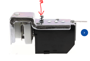

Similar to this, p-poor arrow but the release button is at the end of it:p:
Can't see the set screw. Will try the release behind the dash. Thank you.
